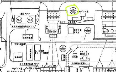

A couple of notes from this good document:
http://www.tepco.co.jp/en/nu/fukushima-np/f1/images/f12np-gaiyou_e.pdf
1. Page 22: "Treatment of sub-drainage water after being pumped up"
So this is really all TEPCO can do about the underground water. They must pump it up from the unit 1 - 4's sub-drainage pits and handle it.
But please note this only concerns the water that has been accumulated in the sub-drainage pits.
I guess the contaminated water from the plant may find some routes below the level where the sub-drainage systems are working. And below that level you cannot really do anything.
And there is also a massive load of tsunami waters in the area which has affected the groundwater levels. What happens to the sub-drainage systems if there is "too much" water for them to handle? Anybody knows?
I am really amazed by the fact that TEPCO has been so quiet about the level of water in the unit 1 - 4's sub-drainage pits and also that they have not stated when they are going to empty them.
BTW, on the 5th of April they emptied 1 500 tons of water from the unit 5 - 6's sub-drain pits to the sea, according to IAEA. This water was low-level contaminated:
http://varasto.kerrostalo.huone.net/salaojat_1.png
2. Page 28: A really cool picture about how far the tsunami waters traveled in the Daiichi and Daini plants. :cool:

TCups said:
<..> Can someone tell us more about "radwaste buildings" please?
http://i306.photobucket.com/albums/nn270/tcups/4000d390.png
The Centralized Radiation Waste Treatment Facility is the complex of buildings to the south of unit 4. It is separated from the area around unit 4 by a road leading to the sea. The treatment facility has 4 main buildings: the Process
Main Building, the Miscellaneous Solid Waste Volume Reduction Treatment Building, the On-site Bunker Building, and the Incineration Workshop Building. You will see on photos, that the buildings of the treatment facility is intricately connected to the southernmost exhaust stack of the plant.
According to plans, the highly contaminated water from the turbine building of unit 2, including the famous trench, is to be pumped to the Process Main Building of the treatment facility (since that building has the largest capacity for storage). I suppose the Process Main building is the large building to the seaside of the complex.
Transfer of the contaminated water via hoses involves crossing two roads, the road between unit 2 and 3, and the road between unit 4 and the treatment facility. It also involves passing _through_ turbine building 3 and 4 (for the purpose, a hole has been made in the walls between the two turbine buildings).
