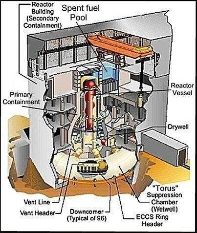

Um... very silly question which just plopped into my mind:
There were hydrogen explosions in Units 1 to 3, hydrogen was generated after zircalloy reacted with hot steam. To prevent explosions inside the RPV and to lower the internal pressure, hydrogen was vented. This vented hydrogen exploded then inside the reactor buildings.
The thing I don't geet: Why ended the relieved hydrogen up in the reactor buildings? If I would've to construct an emergency venting system at a nuclear power plant, I would make sure that the vented gas lands outside the buildings and dilutes in the air.
So why did they vent into the building?
The only possible explanation coming to my mind is rupturing of the relieve valves due to high pressure...

And I know answer: yes, all bwr reactors after TMI were upgraded with additional venting system but it need power, no one expect that at one time reactor can lost 3 power lines and backup generators... no power no venting

Last I heard they had an electrical operated shut off valve that failed shut. It needed electricity to open, and there was no electricity. Nobody has explained why that valve was in the system when the worst case scenario would have it that the reactor plant lost electricity. That, of course would result in overheating of the core and the necessary venting. Unfortunately if the valve is shut because of a loss of electricity, YOU ARE ROYALLY SCREWED.

This has been a point of discussion elsewhere, and perhaps here as well. The consensus in other discussions was that there should not be a design path to vent into the building and what occurred was not intended or expected. Failure of valves, structure, or perhaps the failure of seals due to over-pressure are possibilities for allowing H2 to vent inside the building.

It has been reported that the plants had installed hardened wetwell vent systems to be used to vent the containment from the suppression pool airspace to the offgas stack outside the building. In the case of uniit one the containment pressure was more than 2 times the design limit before they started to vent. Containment may already have been leaking or the overpressure could have caused leaks in the vent piping inside the building. About 1 hour after completing the venting unit 1 exploded. The system was not designed to vent into the building, but something must have leaked.

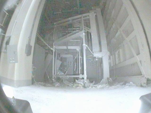

Indeed. I found a blueprint of the service floor layout, supposedly of units #2--#5, in this page
http://fukushimafaq.wikispaces.com/3D+and+Autocad+Rendering+%26+Analysis
and a fisheye view of #4's service floor:
http://www.houseoffoust.com/fukushima/possibles.html
http://www.houseoffoust.com/fukushima/reactor4_insideplain.jpg
As others have observed, the layout of #2--#5 seems to be very different from that of #1. There is no separate pool for cask loading between the service pools and the elevator, and the N-S arrangement seems reversed, with SFP and elevator near the South wall. Presumably the the function of the cask-loading pool is performed by a small enclosure within the spent-fuel pool (square on the outside, round inside), at its NW corner.
Now if only I had the vertical cross-section blueprints of one of the 2--4 buildings

At least at Unit 1 they manually operated the hardened vent valve. The worker who performed that task received a significant dose that was reported in TEPCO Press Releases. Since that was well after batteries would have been drained I assume they also vented units 2 and 3 manually.
The WSJ article posted by MSCHARISMA describes the fact that the venting was manual.

Indeed, very interesting:
Containment- Venting: Existing BWRs employ primary containuent venting systems
to provide the venting c apabi l i ty necessary for containment ine r t ing prior to
reactor s t a r t up and de - ine r t ing prior to personnel entry i n to the primary
containment. Most exi s t ing plant emergency operating procedures c a ll for
containment venning when containment pressure reaches or exceeds ths design
value (48 to €J psig or 331 to 414 kPa gauge) . 35-37 Failure of the vent system
ducting is l i k e ly under the se circumstances, since the systems were not
designed for such pressure d i f f e r e n t i a l s. Such ducting f a i l u r es would allow
the vented material to discharge directly into the reactor building, flooding
the building with steam and combustible gases, and e f f e c t I've ly eliminating
further access to the secondary containment. Backfitting of dedicated "hard"
vent systems (which employ high-pressure ducting throughout the ent i re system
but no f i l t e r s) has been suggested as one mechanism for improving vent
r e l i a b i l i t y. It should also be noted t h a t, exi s t ing containment venting
systems would not be functional during s t a t i on blackout sequences. Power
(d. c. or a . c. or di r e ct human manipulation) is required for vent valve
operation.
So the longer they waited, the more they increased the possibility of an explosion? Ouch...
But that's only Unit 1. As for Unit 2, the venting was apparently successfull - an explosion only occurred in the wetwell (torus). But what went wrong with Unit 3? Same failure as Unit 1? Does anybody know how high the core pressure was when they vented Unit 3?
wiki is filled with unreliable data..
I posted the fish eye picture here with source it is not from #4 but from #5 (the one on the extreme north of the plant)
And the service floor BP linked on the webpage was posted here originaly few dozen pages down and is not from Fukushima.
