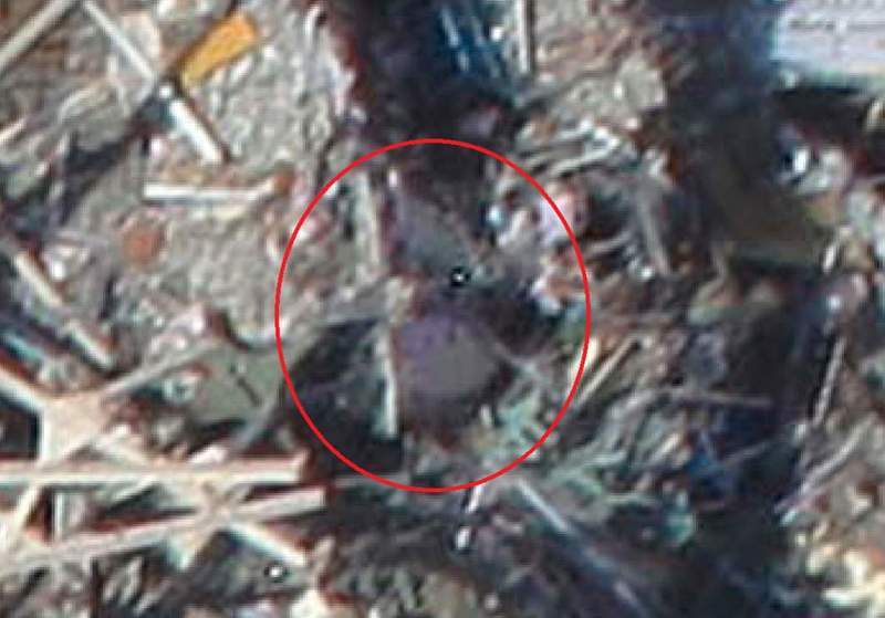

fluutekies said:
Right! This finally explains also the hot spot in the thermal images outside of building 4 at the corner, corresponding with the "dark fluid" on the ground between the debris (you marked it in a previous image). Do we have dose rates of this spot?
Indeed on some of the thermal images, there appears to be unexplained heat originating from about that location. Thanks to THawk we can see two objects of appr. fuel rod assembly size lying there, caught in the rebar in the "window-sill" . (see attachment)
