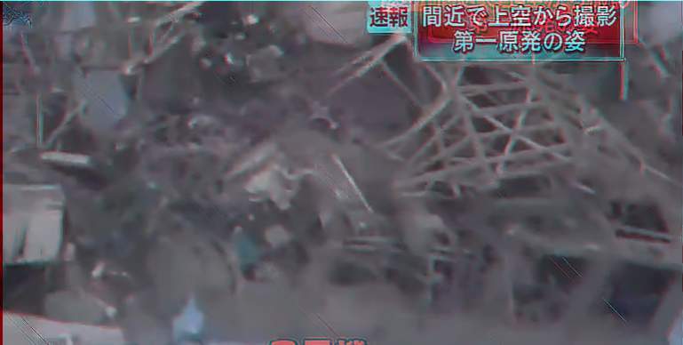

Tepco released a new video of taken by T-Hawk on 21.4.2011 flying between the reactors and turbine buildings from unit 1 to unit 4, can be downloaded here http://www.tepco.co.jp/en/news/110311/images/110427_thawk.zip

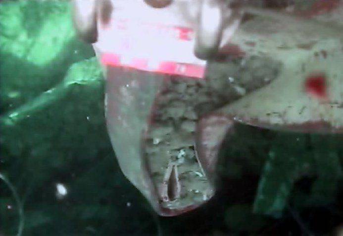

picture released 26.04.2011 of Remote-controlled crawler dump (pictured on April 15, 2011)
http://k.min.us/ilrN2q.JPG

They're continuing to release material of low value and quality. That T-Hawk video is a joke. They're probably using the T-Hawk everyday and use its IR-camera, too. Getting to see a few more details of the east side of the buildings is okay, but there's not much to see there, really. And it's stuttering. Similarly with these tiny packbot pictures. It's as if they release it so the press has something to show. From media perspective, the released material doesn't differ from previously released material and thus is of low value (in addition to being low quality!). It's as if they want to bore the media into not showing more about Fukushima.
I'd like to see the SFPs up close, same with the inside of #4's service floor, and if they can manage, the drywell lid over #3. They have bots to do that, what's the issue?

Now, now.. Rather enjoy some extra candlelight (however tiny it might be) than curse the darkness :-) I admit, this video stutters distractingly. However, the keyframes are actually pretty good, and they depicture objects we have not had a good view of before, from a so far unseen angle, and with a resolution down to a few centimeters at its best. And , it is _very_ well shot by the operator of the THawk, I must say, I bet he has been on a steep learning slope.
I am actually quite excited by this new video, and thankful to Tepco for making it available. I am not at all through with studying it. Colors of the m1v video from the Tepco website did not make it on my system, but there are perfect coloring flv versions on Youtube and other sites, e.g
Basic operator training for the T-Hawk costs somewhere >100k$ afaik, so that course better pays off.
The trouble I have with these releases is: they hopefully utilize the T-Hawk and the packbots every day. Yet, what the public get to see is, like you say, a candle-light. There should be a whole lot more information available.
I know that how much information should be released during a disaster is controversial. My view on this is: the more the better. Cranks will always make their own theories, no matter how much information gets released (see e.g. the still debated theory of a "nuclear fission explosion" in #3). But with more information available, experts have more leverage. If its not the case, well... more questions, less answers. Cranks will always give answers. The media likes answers better, so the cranks win.
Additionally, withholding information undermines the trustworthiness of a company. The damage is already done, there's no PR battle to be won for Tepco. They can only worsen their position.
I'm working on a merged version of the t-hawk footage (photomerge), but apparently my workstation is running on faulty ram, blegh.
