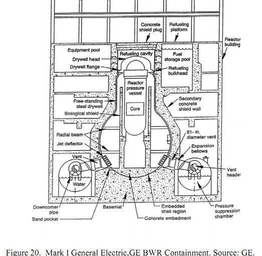

clancy688 said:
I'm not so sure about the hydrogen explosion. Wikipedia states that nobody is sure what caused the big explosion. There's only the fact that the reactor went to 30 GWt and then KABOOM.
I don't think that a hydrogen explosion is very likely. I'm not a chemist, but a hydrogen explosion would mean, that the reactor must have generated enough hydrogen to destroy the building and lift the 1000 ton heavy reactor cap upwards in just a few seconds <..>
I think the first fraction of a second of the blast did represent an initial hydrogen explosion, which blew away, crucially, the west wall support for the overhead crane, so that the two heavy booms and the crane itself fell on top of the reactor lid.
We know from overfly videos that the northern boom indeed has sunk partly into the service floor, and in that process has completely devastated the concrete deck at the west end where it fell. The fallen overhead crane has fallen on top of something, at the very least it must have its hook etc uderneath it, and those things must have pressed powerfully into the reactor lid. I think this hit from the overhead crane triggered something akin to a BLEVE (a boiling liquid expanding vapour explosion) from the area of the lid or from the area close to the SFP chute. A BLEVE can be extremely powerful, and it will produce a high buoyancy airmass (1 m³ of hot water flashed to vapor has a lifting power of about 1000 kg). A bleve will splash a lot of hot liquid water around too.
It is a somewhat overseen fact that the explosion of unit 3 really produced a lot of steam, quite unlike unit 1, and not only in the shape of a mushrooming cloud, but also coming from ground level from water apparently splashed as far as to unit 1 (counter to the wind direction!) , also a lot from the area around unit 4. Indeed the satellite photo taken 3 minutes after the explosion strongly suggest there's water on the roof of turbine building 4. As if it had just rained.
I may well be wrong about several things in this scenario, but whatever the exact chain of events may have been, I think the character of the explosion at unit 3 becomes inexplicable unless we assume that it in some way involved the expulsion of large amounts of hot water under pressure. It certainly was not (just) a hydrogen explosion.

TCups said:
OK, thanks Astronuc. Then, at least in my opinion, having not been convinced otherwise by any hard data or inconsistency in the photographic or video evidence, I am still clinging to the sequence I had first hypothesized: 1) hydrogen explosion in the drywell containment of RPV3, 2) directed venting of the explosion into the upper SFP3 via the fuel transfer chute (and also into the torus), 3) secondary explosion of the hydrogen in the upper floor of Bldg 3 (also from hydrogen originating from the reactor core of Unit 3 and probably not SFP3 damaged fuel), and, almost simultaneously, 4) hot water vaporization/steam explosion mushrooming vertically from the SFP3.
What is the source of the oxygen for a hydrogen explosion in the dry well?
See this post - https://www.physicsforums.com/showpost.php?p=3213820&postcount=1622
The drywell should have been inerted, but with an overpressure event, leaks could have developed. I'm not sure the explosion happened in the drywell, but above the drywell and above the reactor service floor in the seconary containment. The hydrogen and some steam leaked from primary containment up into the secondary containment where the hydrogen ignited in air.
Unit 3's explosion was significantly great than that of unit 1. Unit 3 has a larger core, and there is some thought that seawater is more corrosive than normal reactor water - it cerainly is for stainless steel - but it may be more corrosive for Zircaloy in the presence of soluble iron (Fe3+), and thus Unit 3's core produced a lot more hydrogen than Unit 1. Unit was didn't have seawater injection before it popped, whereas Unit 3 had seawater injection about 22 hrs or so before its explosion.
