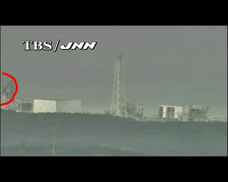

It was suggested that I share this here. A couple of people had mentioned #4 looked like it was falling over or it is an optical illusion of the wide angle lens on the TBS camera. I am not totally convinced it is the camera since there is no oddity on the opposite side of the camera. I also have a screen shot that shows even further right of #4, everything is totally vertical. #3 isn't leaning, as if there was a distortion, it would gradually get worse rather than being sudden in one spot only. I marked up a couple of images to explain what I was seeing. TEPCO also moved the watering crane that has been on the south side of #4 to the corner of #4 on the land side about 4 hours ago. I don't have a screen shot yet but the person who saw it is reliable. I am hoping to get a screen shot of that once it is daylight again. Another concern to add to this is that TEPCO employees were telling a couple of different Japanese reporters I have spoken to that the stability of #4 was a big concern. This was about 2 weeks ago. The concern was the building framework instability and the impact it is having on the SFP. There were plans to pour concrete columns underneath and also a plan to put a steel framework underneath. There is already damage to the frame work on both the north and south sides.
Image of all reactors and towers http://www.houseoffoust.com/fukushima/sinking.jpg
Close up of 4 http://www.houseoffoust.com/fukushima/sinking5_6a.jpg
4 with lines tracing the building framework http://www.houseoffoust.com/fukushima/sinking5_6b.jpg
large image of reactors with vertical lines http://www.houseoffoust.com/fukushima/sinking2.jpg
web page of all of this http://www.houseoffoust.com/fukushima/r4sinking.html

I too think that #4 looks like it's leaning in these images, but I am not convinced that's it not an optical distortion of some form. The low resolution also hinders analysis. Does anyone have recent images from a different angle to compare? A satellite image would be good.
Welcome Nancy... Thanks for the images you have posted on your site.
NancyNancy said:
...TEPCO also moved the watering crane that has been on the south side of #4 to the corner of #4 on the land side about 4 hours ago. I don't have a screen shot yet but the person who saw it is reliable.
evidence please? A picture would be good :)
NancyNancy said:
...TEPCO employees were telling a couple of different Japanese reporters I have spoken to that the stability of #4 was a big concern...
link please? The collapse of the building would be a very bad development...
  • #6,078
Nancy, there are a few things in those images you must take into account:
(1) The camera is a bit tilted. Your 'vertical' lines are a bit off; check carefully the tower, you should tilt them clockwise by a couple of pixels at each end.
(2) There is, definitely, radial distortion of the barrel type, stronger in the high-zoom images. Check that the vertical edges of #2 seem to be leaning counterclockwise, as much as #4 seems to be leaning clockwise. Because of that, the 'vertical' in the corner where #4 is should be tilted even more clockwise.
(3) The upper edge of the South wall of building 4 is damaged and has been displaced down by 1-2 meters, and there is a large foreign object sticking out of the roof at the NE corner (on the far side of the building, near the center of its outline on the photo). Thus the pink lines you drew to show the outline of the building are incorrect. The top of the building is actually almost level with the camera, so the outline at the top is very nearly a single straight line from the upper left corner to the upper right corner (like that of #2).
(4) There is some dark obstacle (a tree?) near the base of the right edge of #4 in tht photo. That obstacle gives the impression that the right edge is more tilted than it really is.
(5) The pillar at the NW corner, that defines the left edge of the building in the photo, was damaged too. Its middle part bulges out by a meter or two. What you see in the webcam is only the upper half of that pillar, which therefore seems to be tilted.
Thus I think that the "leaning over" is an illusion due to the unlucky combination of effects, all conspiring to tilt the outline of #4 clockwise.

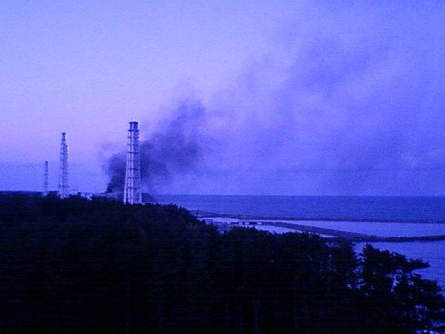

You can see red concrede pump on live cam now...
And it seems the smoke from reactor 3 is black (and thick). Look at this short excerpt from the live feed.
http://goo.gl/JBdwI
  • #6,083
http://goo.gl/JBdwI
I don't see much there. It's dark. Looks "normal" to me.
  • #6,084
Hm, this array of screenshots from apparently (can't verify) a few hours ago doesn't look very 'normal' or am I mistaken
http://twitpic.com/4unrpd
  • #6,085
No. 3 blew up again.
The live cam seems to verify it.Edited
  • #6,086
That black smoke (if it is black smoke) could be coming from #4.
I'm sceptical about interpreting low resolution pictures at night.

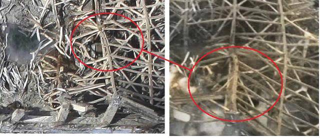

Here is another stab of it (a higher resolution image is attached):
[URL]http://gyldengrisgaard.dk/fuku_docs/20110324_down_3thumb.jpg[/URL]
1) Approximate location of apparent kink in the northern boom of the overhead crane (as if it is bent or broken)
2) Approximate location of fire with grey/black smoke on March 21st-22th. Soot on roof girders and wall concrete structure. At floor below, dark shape or possibly crack in service floor.
3) Signature of heat on the winch, and possibly a burn through of the southern boom in this location
4) Missing rails on the top of this section of the southern boom.
5) Areas in which the booms have sunk into the concrete deck of the service floor, extending the NW broken region of the floor.
