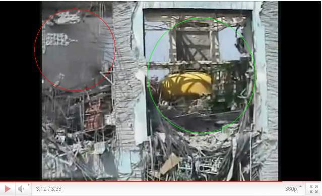

  • #6,011
AntonL said:
correct, unless electronic zoom or electronic selection of a part of the complete frame is transmitted
EDIT: correction, I took another frame of the TBS/JNN feed and drew some lines
looks OK to me
[PLAIN]http://k.min.us/inqMBW.JPG[/QUOTE]
Thank you. Appreciated!
