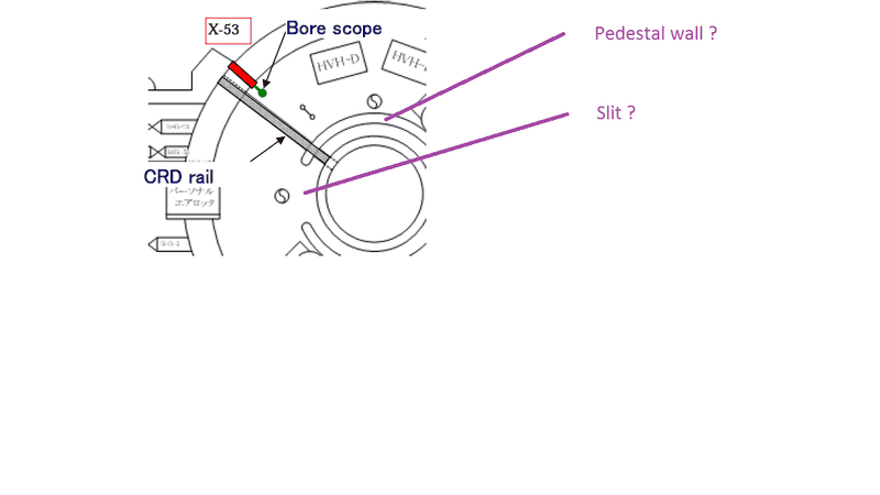

I'm still trying to find an accurate description and drawing of what this hardened venting (enabling it seems direct venting from primary containment to environment) looks like. I read somewhere that some venting -like the illustration below- was placed in the Torus, but this is secondary containment.
http://www.netimago.com/image_201117.html Does hardened venting means direct venting from primary (so with pressures much higher)?
These are the major mods in the US.
http://resources.nei.org/documents/japan/major_mod_usbwr_4511.pdf
It's not clear if they were implemented in Japan.
