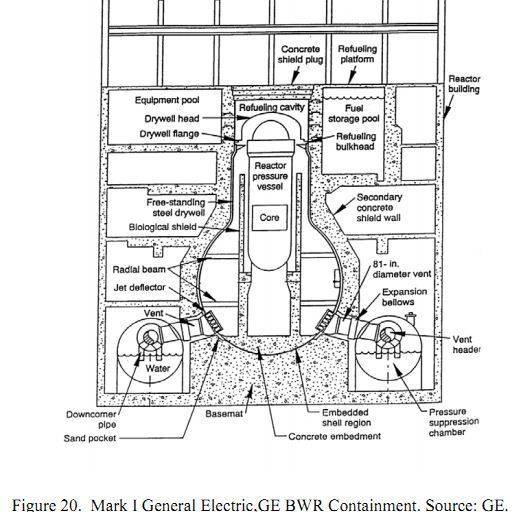

Thanks! Your link is great, now I understand, there is no basement from my perspective, but they call the thorus level basement, as I suspected.
One question, why nobody considers that possibility that the water in the flooded basement has come in contact with the Corium?

Bioengineer01 said:
What do you mean by basement when you refer to Unit 1? There is no basement below the PCV, just a concrete basemat? correct?
https://www.physicsforums.com/attachment.php?attachmentid=36166&stc=1&d=1307221110
The basement is the free space below ground level. Most of it is occupied by the cylindrical concrete block that supports the primary containment vessel, and by the surge suppression torus. According to some floorplans I have seen, the whole basement has a square outline; it is divided by thick internal walls into an octagonal room that spans the four outer walls and houses the torus, plus four small triangular rooms at the corners. Presumably those five spaces are connected by doors, stairs, pipe passages, etc..
The leak of radioactive steam just found on the ground floor seems to be located over or near the southeast wall of the octagonal room in the basement.
With the levels of radioactivity of the water in the basement it is quite obvious that the water must have been in contact with melted fuel rods. What makes you say that nobody is considering this?
That's a distinct possibility. I don't think anyone has ruled it out. It's not much of a stretch to think that the cooling water flowed into the RPV, some of it circulated in contact with the corium at the bottom, and then ended up in the drywell. When the level of water in the drywell rose to the height of the connecting pipes that lead to the wetwell, it flowed into the torus. That path is normally used to convey steam, but those ducts could just as easily pass water once everything at the bottom became flooded.
AntonL mentioned how the torus might want to float if its surrounding trench/basement became flooded. That could be true also, but it's possible the gaseous vent system - electrically operated - failed or shorted out once submerged, and eventually structural failure ensued thus releasing any trapped air/nitrogen/hydrogen/etc.. There was a reported sound of an explosion at Unit 2 early on that TEPCO attributed to structural failure of the torus. Would anyone be surprised if the toruses (tori?) in units 1 and 3 also failed and people just weren't around at the time to hear the noise?
