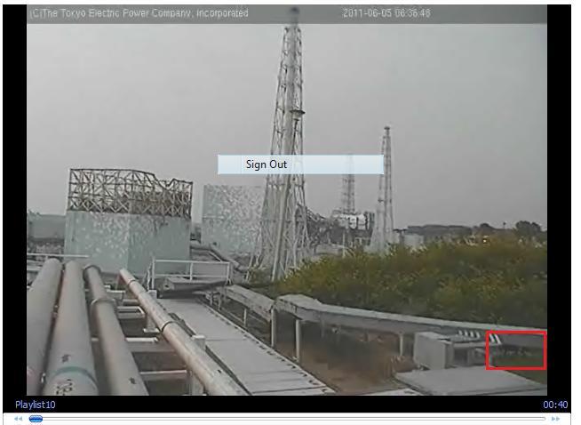

OT
just watched the http://www.tepco.co.jp/en/nu/f1-np/camera/index-e.html" wondering if it's not playing in a loop, things were so quiet. And there comes this badger-like animal going right on the roof to the right of the pipes & then jumps down and goes out of frame. Amazing. I'm convinced now the camera is for real :)

shadowncs said:
OT
I've seen this animal several times on the webcam, the first time i was quite surprised!
