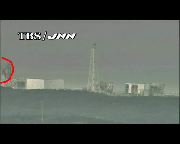

Is this the crane? I can't see it on the TEPCO feed. Screenshot taken at 09:45 GMT

As for the crane around unit 1, its been doing stuff almost every day at unit 1 for some time now - often appears to be dangling a probe of some kind, though in locations that are not intuitive to me.
