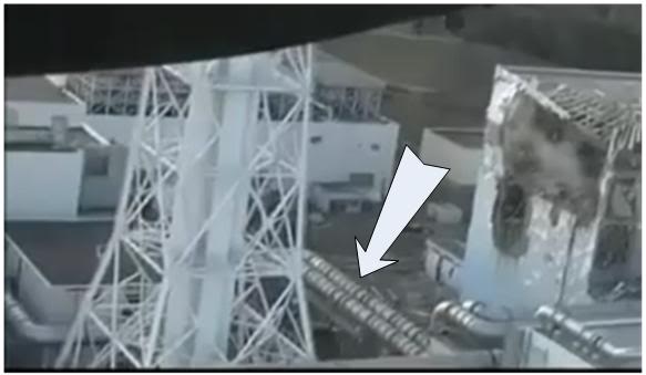

New video material has been released to the public including close up on the roof of unit 3, 4, 2 and 1
I estimate that the footage give some evidences that the debris that we though were rod are not.

@FRED: yes the quality of the video in not very good, but on the reactor 3 what is shown is not, in my opinion, the "things" that has been extracted from the first video (the supposed rods), i only see here (seeing means guessing on this video) structural steel from the roof. The sticks had a different appearence and were on one side (if i remember) of the building, ready to fall down. I would need to see the good quality video, probably soon on youtube anyway.

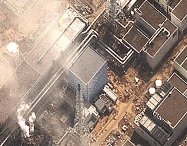

  • #1,127
curious11 said:
What is this feature? It looks like the top of a whiskey distillery. Note the round opening at the top.
If it is indeed the the top of the reactor it is in the wrong place, suggesting the reactor was destroyed by the explosion in building 3, which has been my "best guess" for some time.
Sorry if this has already been commented on; I've been away for a few days.
  • #1,128
I think that the round feature is the top of the tank just above it

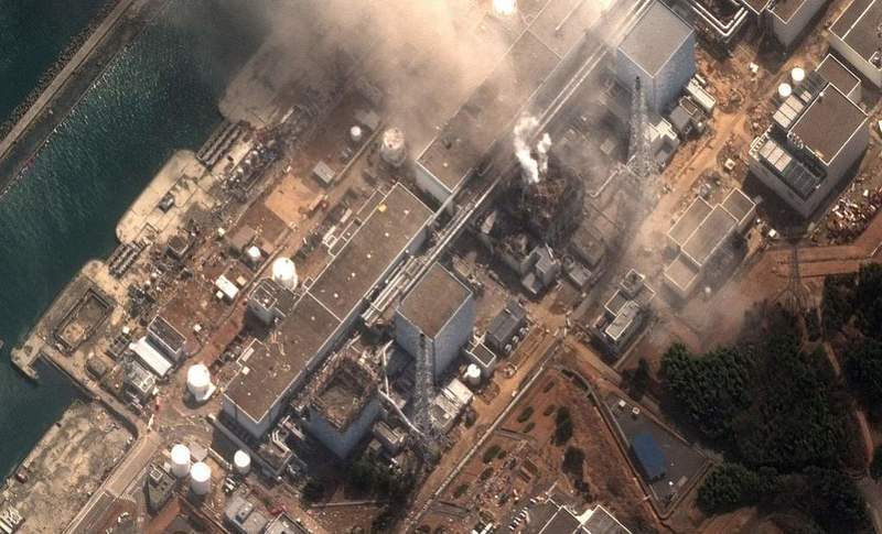

  • #1,130
curious11 said:
Fascinating analysis and discussions on here.
The containment explosion hypothesis seems a likely explanation for the multiple explosions heard during the reactor 3 event. ie pop 1 being the pressure vessel, pop2 being the primary containment, and then pop 3 being the unpressurised hydrogen in the roof void. Although I would not have expected such large durations between each pop, and there are no visible signs of 3 independent explosions.
To add another area of curiousity, has anyone considered what the grey area that appears to have emanated from reactor 3?
http://patrick.reformstudios.com/p.jpg
I know I'm going back a long way here, but this grey stuff (did you work out what it was?) seems to have been ejected in two directions 180 degrees apart Not quite perpendicular to building layout) as there's some on the roof of the building bottom right, that I think has a hole in it (out of shot). the hole suggesting this material to be either very heavy or very hot.

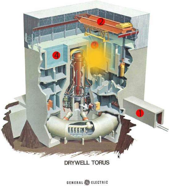

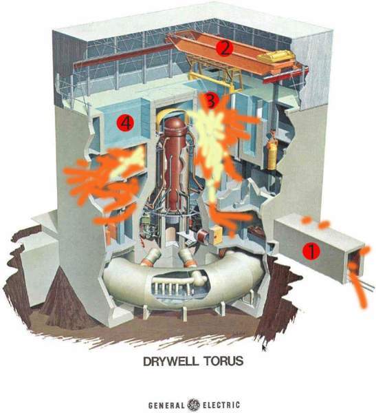

Ok, i would like to bring some more material here. Lots of things to summarize.
The first thing is that i just captured several shots from the live NHK world when they were talking about the 3 workers injured in the basement floor beacuse of the contaminated water. They we're asking a specialist from Tokyo University where this water could come from and he had a nice drawing which i think is a new important element for our analysis here because it seems quite accurate, and it's a transversal cut view through the reactor and turbine building. I let them big if no problem for the forum admins because it's much easier to see some details (the resolution is not excellent).
I post them first and will add infos and comments after.
http://www.netimago.com/image_182135.html
http://www.netimago.com/image_182136.html
http://www.netimago.com/image_182137.html I have a 4th one which completes the overall view of the buildings and layout which is a view from the top, a cut view also, at the level of the basement (i would say at the ground level approximatively).http://www.netimago.com/image_182143.html
Position of the workers injured by the highly contaminated 15cm to 30 cms water laying on the floor:
A) Based on the infos the guy from Tokyo University gave, the 3 workers were in the lowest room, between the torus room (on the left) and the turbine (on the right), where the blue pipe linking the reactor anf the turbine (steam pipe) goes down (on pictures 1 to 3).
B) the guy situated them on the other drawing (picture n°4) close to the big red inscription at the bottom right of the image (so quite far away from the reactor position).
The specialist interviewed also said that he doubts the water could come from the spent fuel pool (because of the level of contamination), but said it could come from a broken pipe coming from the reactor. He also said that the day before, an other shift reported no water here. Very surprisingly (for me), then didn't evoke the possibility that this water could also come from the suppression pool which is almost at the same level just behind the wall on the drawing...
These drawings give some interesting informations, we see the level at which the suppression pool is installed (quite deep under the ground) but we also see that the turbines are actually well under the ground either!
That's really scary when you think about risks of flooding... By the way, this probably means that seeing the flooding of the plant from the helicopter shot (just after the tsunami), these rooms have been flooded also? What do you think? Then they would have needed to empty them which could explain the time spent to access these areas?
I'm very surprised to see this kind of layout for the turbine an connecting buildings...
Right AntonL, we were guessing pretty well with the bits of infos everybody brings here. The puzzle is assembling.
Something else: looking at all these new informations on what's inside, i relate the position of the turbines and the position of the big hole in the roof of this turbine building: was this hole done by a big debris coming down after the explosion or was it done DURING the explosion by one of the turbines just blowing out? The hole is right at the top of the turbines:
said that the day before, an other shift reported no water here. Surprisingly (for me), then didn't evoke the
possibilty that this water could also come from the suppression pool which is almost at the same level...
Not Bad - https://www.physicsforums.com/showpost.php?p=3207270&postcount=1045"
OK I made a mistake I thought is as upper level but now we know it is the basement
