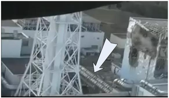

I would like to draw your attention to a last remark i just made (and it probably answers a question I've had for some time looking at the images of the ruins of the reactors). Looking from outside of the reactors, we assumed maybe that they are centered in the middle of the reactor building. I've seen variations on the differents schematics that have been posted around but if the drawing that the scientist from Tokyo University showed at the NHK is correct, which i believe it is, then it confirms that THE REACTOR IS NOT AT THE CENTER OF THE BUILDING VIEWED FROM THE TOP, but pushed towards the turbine building (because the east side of the torus below the ground is actually below the connecting building and not below the reactor building). So the reactor head is shifted towards the East (toward the sea).
Now we can try to speculate if the smoke plume from this building is coming from this place or not, but if think it is (satellite picture just after the explosion, 14th or march):
http://www.netimago.com/image_182152.html
http://www.netimago.com/image_182153.html
  • #1,155
@TCUPS: did you have a look at my post just above yours and at my other post with the big captures of the drawings on the NHK TV at page 72 of the thread?
Because i think they answer some of your questions concerning the basement, the location of the workers and water, the location of the basement relative to sea level,and confirms also your remark concerning the shift of the reactor towards the East side of the building, and the corresponding smoke position...)
