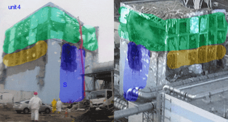

I don't know how I missed this before, but here is what I think I see. The building designs and overhead cranes in 3 and 4 are different than in 1. The overhead cranes in 3 and 4 are mounted atop massive steal beams that run north-south, and that are supported, indeed have to be supported by the reinforced concrete columns on the east and west sides of the building. The weight and size of the beams that are the tracks for the crane, in turn, reinforce the bearing weight-bearing columns of the top floor of bldgs 3, 4.
The hydrogen explosion in the top floor of 4 spares most of the roof and all of the columns on the east and west sides because of this relationship to the construction and weight-bearing functions mentioned. After the explosion, you can see that the structural damage to the roof and most of the structural damage to the side walls of Bldg 4, are therefore most severe at the north and south ends of the building.
The same holds true for Bldg 3, except that
1) the explosion at Bldg 3 was much more powerful, and
2) the explosion at Bldg 3 results in the north wall weight-bearing columns buckling and the crane structure itself sliding or being blown off of the rails and falling from the top floor of Bldg 3 to the top of the smaller, adjoining building below on the north side of Bldg 3.
The fuel handling machenery (green) still sits atop the SFP of Bldg 4, but not at Bldg 3. The SFPs are at the southeast corner of both Bldg 3 and 4 as has already been confirmed.
The concrete panels between the structural weight bearing columns of Bldg 3, because of the much larger size and power of the blast in Bldg 3, resulted in the concrete panels between the weight bearing columns on the east and west sides becoming more effective "bullets" when they blew out en mass, from between the columns, doing the damage to the adjacent roofs of Turbine Bldg 3 and the building in back, on the west side of Bldg 3. The size and power of the blast also did much more damage to the superstructure of the roof girders of 3 than 4, but it would still appear that the roof girders over the drywall containment plug of Bldg 3 are not completely destroyed after the explosion. Hence, the drywall containment plug was not blow straight upward.

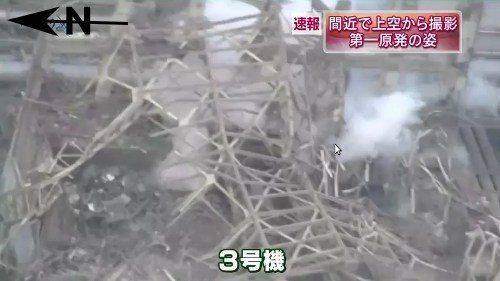

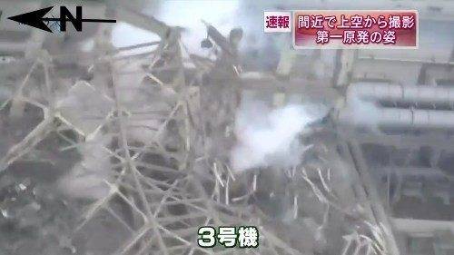

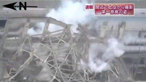

And this close-up of steam venting in the region of the SFP of Unit 3, I believe, reinforces the opinion (speculation on my part) that the containment of Unit 3, more specifically, the drywall containment at the location of the fuel transfer gate(s) and chute to the SFP is the source of the breech and the venting steam (diagram following).

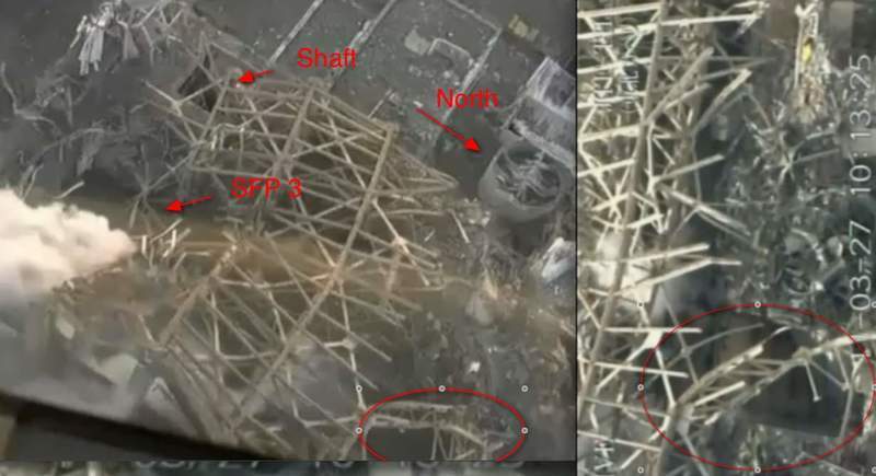

This image of debris atop Bldg 3 suggests to some (myself included) that the blast displaced spent fuel rods from Unit 3's SFP, but this has not been confirmed.
