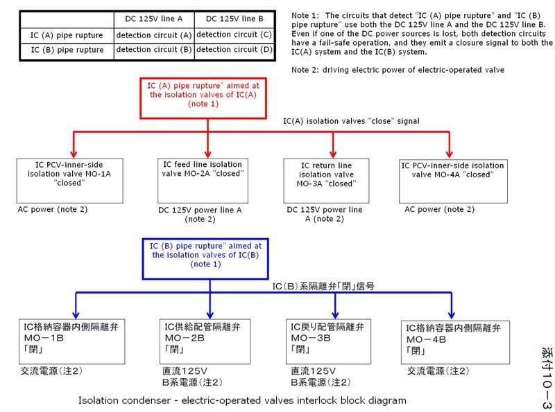

I translate some bits of Tepco's internal investigation interim report:
Attachment 10-2 ( http://www.tepco.co.jp/cc/press/betu11_j/images/111202f.pdf page 281/314 )
About the Isolation Condenser
1. Status before earthquake (idle)
* There are two systems: system A (left part of diagram below) and system B (right part of diagram below)
* In normal time it is idle, A system's MO-3A valve is closed, and B system's MO-3B valve is closed.
< diagram > [happens to be the same as the one on http://www.tepco.co.jp/en/nu/fukushima-np/images/handouts_111122_03-e.pdf page 2]
2. When it is running
* Due to manual operation, or to automatic operation signal (due to high reactor pressure), A system's MO-3A valve and B system's MO-3B become opened.
* As a result, all the valves in the RPV-->IC-->RPV lines (valves 1A, 2A, 3A, 4A for system A, valves 1B, 2B, 3B, 4B for system B) are open.
3. When the isolation signal has come
* The isolation signal is emitted upon detection of rupture by the pipe rupture detection circuit, or upon a loss of electric power (DC power) suffered by that circuit.
* When the isolation signal is received, the interlock, which closes the valves installed in the line (valves 1A, 2A, 3A, 4A for system A, valves 1B, 2B, 3B, 4B for system B), is activated.
Attachment 10-3 ( http://www.tepco.co.jp/cc/press/betu11_j/images/111202f.pdf page 282/314 )
Isolation condenser - electric-operated valves interlock block diagram
Attachment 10-3 English translation
Attachment 10-4 ( http://www.tepco.co.jp/cc/press/betu11_j/images/111202f.pdf page 283/314 )

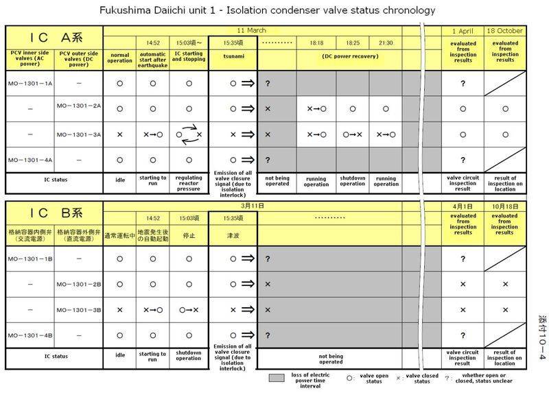

Fukushima Daiichi unit 1 - Isolation condenser valve status chronology
Attachment 10-4 English translation

  • #11,899
Thank you tsutsuji
You middle diagram could explain why the IC wasn't able to operate after the tsunami. It states that the IC received a isolation signal so the AC valves inside containment were commanded to close.
Since they are inside containment they are impossible to open (containment is inerted with N2). It will probably be more than a year before they can be inspected.

matthewdb said:
Thank you tsutsuji
I was just about to write the same reply, but you were faster..
Finally this isolation condenser mystery is starting to make sense: loss of DC results into a (spurious) system isolation due to the fail-safe direction of the valves, and depending on whether or not there was AC available at the time of loss of DC, the inner IC valves (4A and 4B) may have closed at that time.
Since steam was reportedly observed at 18:18 upon opening the 3A valve, it might suggest that the 4A valve would have remained open in spite of the closure signal, but that remains to be seen.
Once again, thank you, Tsutsuji-san - you're helping many people to get understanding of the situation.
Deciding the fail-safe mode of different valves is always a difficult optimization task. In the GE BWR:s, it seems that fail-close has been a very dominating design principle (thinking of the difficulties in lowering the reactor pressure and now this issue of possibly losing the isolation condenser due to the return lines fail-closing). Possibly worth a thought or two at other NPP:s as well.

I would urge a little caution as there are other questions to answer. The F1 operators tried multiple workarounds in venting and other actions they took in the early hours. Isolation signals can be reset or jumpered out. Alternatve power sources can be rigged. Were any of these part of the actions that night?
The information provided by Tsutsuji has been timely and useful, but in our voracious appetite for answers, we should keep in mind that answers can raise more questions.

I translated attachments 10-2, 10-3 and 10-4 of the internal investigation interim report on https://www.physicsforums.com/showpost.php?p=3674463&postcount=11913
Now I will translate the report's main text at http://www.tepco.co.jp/cc/press/betu11_j/images/111202c.pdf from page 99/140 to 104/140.
I am wondering about the following:
* Isn't the report of radiations higher than normal at reactor building entrance at 17: 50 the earliest radiation release record for this accident ?
* Why didn't they try to start IC (B) after 18:25 when IC (A) seemed to be broken with no steam observed ? Isn't IC (B) supposed to be the backup of IC (A) ? Could they not open the MO-2B and MO-3B valves as they did with other motor-operated valves ?
* What is the cause of the DC power restoration at 18:18 ?
* What were the plant operator's plans concerning the IC before the 18:18 DC power restoration ?
Translation:
3. Examination of the isolation condenser
As mentioned in the above plant behaviour sequence of events, it can be thought that core damage progressed within a short time interval after the arrival of the tsunami, so that it can be thought that it is possible that the isolation condenser status, as an equipment performing reactor cooling in the initial stage after shutdown, brought consequences on the progression of events. The sequence of events which drew our attention concerning the isolation condenser is collected below.
Reference: outline of isolation condenser (see construction in attachment 10-2)
* The isolation condenser being for cooling the reactor when the reactor has been isolated, it is an equipment which extracts steam from the reactor, and returns it to the reactor as water after exchanging heat with the coolant water accumulated inside. It is installed in unit 1 only.
* The isolation condenser is composed of two systems, system A and system B, and the steam circuits are built with 4 valves. Isolation condenser entrance and exit are equipped two valves each, in a configuration where the primary containment vessel is interposed between them. The valves inside primary containment vessel are driven by AC power, and those outside by DC power.
* Normally, it is in standby with the valves outside primary containment vessel (valve 3A and valve 3B) being closed, and all the others being fully open. The starting and shutdown of the isolation condenser is performed by opening or closing the 3A and 3B valves.
* Reactor pressure is controlled by intermittent opening and closure of the aforementioned valves.
< Sequence of events related to the isolation condenser >
11 March 14:52 ; automatic start of isolation condenser
Together with the loss of external power, the power source of the emergency bus was lost, the main steam isolation valve was automatically closed. Due to the "high reactor pressure (7.13 MPa [gage])" signal, both isolation condenser systems started automatically, and as reactor depressurisation and cooling began, reactor pressure started to decline.
Around 15:03 ; manual shutdown of isolation condenser
As the drop of reactor pressure that resulted from the start of the isolation condenser was quick, it was judged that it would not possible to respect the 55°C/h reactor coolant temperature variation speed specified in the operation manual, and the isolation condenser return line valves (MO-3A, 3B) were momentarily turned to "fully closed". The other valves being open, a normal standby status was obtained. As a result, reactor pressure rose again.
After this, in order to regulate reactor pressure at about 6 or 7 MPa, it was judged that one isolation condenser system was enough, and deciding to regulate with system A, and by opening and closing the return line isolation valve (MO-3A), the regulation of reactor pressure began.
15:37 ; loss of electric power
Because of the tsunami flood, all AC power was lost at unit 1. Moreover, DC power was also lost. For that reason, in the central control room, not only lighting but also monitoring instruments and all indicator lamps were extinguished. It created a situation where the isolation condenser's valves open/closed indicators cannot be checked and the isolation condenser's valves cannot be operated.
Around 16:42 ; temporary recovery of water level system
From around 16:40 to around 17:00, it became temporarily possible to check the until then unavailable reactor water level (wide band) (at 16:42, equivalent to TAF (top of active fuel) + 250 cm), and it was confirmed that it had declined since the tsunami arrival.
17:19 ; attempt to check the isolation condenser on location
Because it was impossible to check the isolation condenser from the central control room, it was decided to go to the location where the isolation condenser is installed, and to check such things as the level of condenser shell water, which is the isolation condenser coolant. A plant operator headed for the location, but because the radiation level there (at the entrance of the reactor building) was higher than normal, at 17:50 he temporarily came back.
18:18 ; recovery of DC power for A system outer side isolation valves / opening of A system outer side isolation valves
Whether or not because the DC power had become temporarily unstable in consequence of the tsunami, part of the DC power was later restored and operators found that the isolation condenser's feed line isolation valve MO-2A's and return line isolation valve MO-3A's "closed" green lamps were lit. As the normally open feed line isolation valve (MO-2A) was closed, it might have been thought that all the isolation condenser's isolation valves had been closed following the emission of the "isolation condenser pipe rupture" signal, which is an action toward the safe side following the loss of the DC power used for the detection of "isolation condenser pipe rupture". However, the operators expected that the isolation valves on the primary containment vessel's inner side (MO-1A, 4A) would be open, they performed the valve opening operation of isolation condenser return line isolation valve (MO-3A) and of feed line isolation valve (MO-2A), and the status indicating lamps changed from "closed" to "open".
After valve opening, as the monitoring instruments were not working due to the loss of electric power, and as they had no way to check if the isolation condenser is running, the operators confirmed steam generation from the isolation condenser venting pipe based on the steam generating sound and on the steam that could be seen beyond the reactor building.
18:25 ; A system outer side isolation valve closure
Because steam generation stopped after a while, they closed the isolation condenser's return line isolation valve (MO-3A) and they shut the isolation condenser down.
Moreover, as a response that can be operated in the central control room, they advanced the construction of a water injection line with the fire extinguishing system.
In the midst of unpredictable events occurring one after another, the operators thought about the primary containment vessel's inner side isolation valves (MO-1A, 4A) being closed by the isolation signal, but they worried about the possibility that the shell water, which is the isolation condenser's coolant, had disappeared for some reason. While thinking that the isolation condenser is not functioning, conscious that the construction of the line which is necessary to replenish the shell with water, was not ready, they temporarily closed the return line isolation valve (MO-3A).
Around 20:50 ; construction of reactor water injection line with the fire extinguishing system
The construction of the reactor water injection line with the fire extinguishing system being completed, the diesel driven fire extinguishing pump was started. This brought the prospect of replenishing the isolation condenser shell with coolant water. Later, when operators checked the operation status of the isolation condenser, they found that the closed status indicating lamp of the return line isolation valve (MO-3A) was unstable and starting to fade out.
21:19 ; temporary recovery of reactor water level gauge
It was discovered that the until then unavailable reactor water level was indicating TAF (top of active fuel) + 200 mm.
Around 21:30 ; Opening of valve 3A (start of system A)
Although the reactor water level is above top of fuel, the steam driven high pressure water injection system pump (HPCI)'s electric power faded out and it became impossible to run it. At that time, the isolation condenser was the only high pressure cooling system that could be expected to run. Normally, even if there is no shell replenishment, the isolation condenser can run for about 10 hours. As the diesel driven fire extinguishing pump has been started, it has also become possible to respond to the replenishment of the isolation condenser shell, and as the worry of a lack of water in the shell is diminishing, considering that in the present situation it is not known when the the isolation condenser can be operated again, as the running of the isolation condenser, a high pressure cooling system, is being expected, the opening operation of the return line isolation valve (MO-3A) that had been temporarily closed was performed at around 21:30, the valve opened, and the steam generation was confirmed with the steam generation sound and with the observation of the steam beyond the reactor building. Furthermore, the electric power plant response headquarters' electric power team, going outside of the seismic-isolated building, also confirmed steam generation.
29 March ; recovery of the shell water level gauge
The isolation condenser's shell water level gauge was recovered.
1 April ; check of valves' open or closed status using the isolation condenser's valve control circuit
Forming a part of recovery work, the valves' open or closed status was checked using the conduction status of the isolation condenser's valve control circuit. Due also to the overheat during the accident, it was not possible to check the status of the valves on the inner side of the primary containment vessel, but it was possible to determine the status of those on the outer side. Isolation condenser system A's 3A and 2A valves were open, and isolation condenser system B's 3B and 2B valves were closed.
3 April ; check of isolation condenser shell side water level
As checked with the isolation condenser water level indicator in the central control room, the A system's water level was 63% and that of B system was 83%.
18 October ; inspection on location
The status of the isolation condenser on the outer side of the primary containment vessel could be checked based on a visual inspection on location. Damages were not observed on the main body or on the main pipes, and the valve status was the same as the one checked on 1 April with the circuit inspection. Furthermore, the isolation condenser's water level gauges on location indicated 65% for system A and 85% for system B, and on the same day the values indicated in the central control room were the same.
(to be continued)

The examinations noted below are based on the above sequence of events and on the previously presented analysis results.
< evaluation of the action of the isolation condenser immediately after the earthquake >
* Based on the sequence of operations before tsunami arrival, it can be thought that the status of valves at the time of tsunami arrival was (for system A) that valve 3A was closed, and the 3 other valves were fully open. Concerning system B, valve 3B was closed and the 3 other valves were fully open.
* Also, concerning system A, it was confirmed at around 18:18 that valve 2A, which had not been operated until then, was fully closed. Also, concerning system B too, the circuit inspection performed on 1 April confirmed that valve 2B, which had not been operated, was fully closed. (This fact was also confirmed by the inspection on location of degree of openness indicators on 18 October). It follows that although they were in open state before tsunami arrival and although they were not operated later, valves 2A and 2B were later confirmed closed.
* It is possible to confirm the action of valves 2A and 2B from the open/closed records of the transient recorders up to the initial shutdown operation, so that the possibility of an operator mistakenly operating the valves is ruled out. On the other hand, the design of the logic circuits ensures that in case of loss of the DC power supplying that circuit, the interlock is activated and all 4 valves in each isolation condenser system perform valve closure operations. In the present case, it is thought that due to the tsunami, the logic circuit's DC power was lost, and the valve closing order was activated by the aforementioned interlock. [attachment 10-3]
* Furthermore, the time needed to go from valve fully open to valve fully closed is 15 seconds in the case of the outer side valves, and 20 seconds in the case of the inner side valves. DC power was lost because of the tsunami flooding, but during the interval between the activation of the interlock, which is due to the consequences of tsunami flooding on instrumentation DC power, and the loss of driving DC power, the valves automatically performed valve closure operations.
* If driving DC power is lost during closure operation, an intermediate degree of openness is obtained, but as mentioned above, as it was confirmed that valve 2A and valve 2B were fully closed, there is a high probability that power panels were inundated by the tsunami flooding, the isolation signal was sent to the isolation condenser's valves, and they automatically performed full closure before the driving DC power was lost.
* Also, the valves on the inner side of the primary containment vessel are driven by AC power, and their open or closed status depends on the timing of the loss of instrumentation DC power and the loss of AC power. It is not possible to determine the inner side valves' open or closed status, and everything is possible between fully open and fully closed.
* As a result, the isolation condenser's status after tsunami is not determined by its status before tsunami. [attachment 10-4]
< connection with core damage >
* Due to the electric power loss caused by the tsunami, the isolation condenser's automatic isolation interlock was activated, it became impossible to operate the isolation condenser, and its function was lost. According to the accident analysis code (MAAP)'s analysis results, because it was immediately after reactor shutdown when the decay heat is the highest, it can be thought that reactor water level decreased in a short time, and this lead to fuel exposure (at around 17:46 top of active fuel is reached).
* Then, the isolation condenser (system A)'s DC power was restored, at 18:18 the isolation condenser (system A)'s isolation valves (valves 3A and 2A) were opened, steam generation was confirmed, but as steam generation stopped, at 18:25 valve 3A was closed. According to accident analysis code (MAAP), at that point the core was already exposed, and it is estimated that regardless whether the isolation condenser continued to operate or not after 18:18, core damage would have resulted anyway.
< estimate of inner side isolation valve status after tsunami >
* On 18 October, an onsite inspection of the isolation condenser was performed, and based on the onsite water level gauges it was confirmed that A system's water level was 65% and that B system's water level was 85%. It was also confirmed that the same values were displayed in the central control room.
* Because the water level values indicated on the onsite indicators and those read in the central control room are the same, it can be thought that the data transmission is accurate. Hence it can be thought that the values read in the control room in the past were also indicating the output of the onsite indicators.
* It follows that it can be thought that the values obtained in the central control room on 3 April (A system: 63%, B system: 83%) are also reflecting the values of the onsite indicators. Those results are different from those obtained on 18 October, but since April, it is thought that, for some reasons, the indicated value changed by 2%.
* The isolation condenser's 3A valve was open after the tsunami from 18:18 to 18:25 and after 21:30. Due to measuring instrument error, etc. it is difficult to calculate an accurate estimate, but the water level indicated on system A's water level gauge amounts to more than the consumption necessary to cover the heat generated by the reactor between the earthquake and the tsunami arrival. Hence, although it is not possible to determine the degree of openness of A system's inner side valves, it can be thought that they are open. After the tsunami, some amount of heat removal was performed during the running of the isolation condenser, and it is thought that, as a result, the water level declined to 65%.
* This fact is also in accordance with the result of the witness hearing confirming that steam was generated by the isolation condenser's vent pipe when valve 3A was opened at 18:18 and at 21:30.
* However, as a considerable amount of water is remaining in the shell, it can be thought that, as a result, the heat removal performed by isolation condenser system A was limited. [Attachment 10-5]
