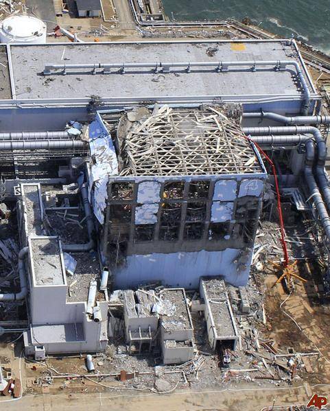

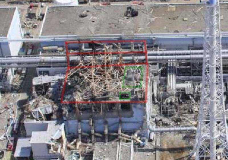

NHK now hints that steam may be escaping from PCV while commenting the latest video.
//www3.nhk.or.jp/daily/english/25_30.html said:
Footage of the No. 3 reactor building shows its roof and the upper section of the building's
southern wall blown away by a hydrogen blast
Vapor can be seen wafting from gaps in the wreckage near a pool for spent nuclear fuel rods.
Faint steam can be seen rising from twisted steel framework over what could be the upper part
of the containment vessel.

On the 25th at 03:13AM JST
The BWR Mark 1 made by GE used in Fukushima is the enhanced one with a bigger drywell (on the right)
[PLAIN]http://k.min.us/ijHsci.jpg
The shape on the right reminds me of an earlier photo showing a round hole atop some "whiskey distillery" shaped object.
