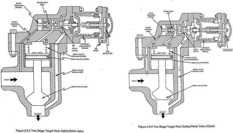

  • #13,118
Hmmm it's interesting to look at Doc's valve drawing
https://www.physicsforums.com/attachment.php?attachmentid=46822&d=1335800918
and ask what would that device do under reverse pressure difference, as if RPV found a path to atmosphere but torus remained pressurized?
Not suggesting that happened, just want to understand what the valve would do.
Looks like with pilot in right position which is command to open , 'outlet' pressure would come up through "main valve piston vent" in lower right and pressurize top of piston driving valve smartly shut.
With pilot in left position, both sides of piston see 'inlet' pressure,
so if ( 'outlet' pressure X seat area product) exceeded 'inlet' pressure by enough to overcome spring plus weight of parts the valve would conduct fluid.
So reversing differential across valve appears to reverse its logic. It'll close when commanded open and vice versa.
Now under stress THAT would be one confusing symptom !
I might try the arithmetic early in the day but not at this hour. Please excuse the old guy, i run out of mental steam anymore.. If my logic is faulty please call me out...
old jim
  • #13,120
Certainly an intriguing idea. It would make for a nice explanation if the hardened vent rupture disk was found to be intact, eventually.

Lot's o great analyses going on here, esp re the valve. Am I correct in my impression that it seems the valve was of a type that should have allowed the RPV to re-pressurize if there wasn't a hole in it already? If so, this would seem consistent with the massive RPV pressure collapse on Mar 13 as marking time of melt-through, and exactly fitting the model of Ott et al.
Well, not quite, but it was a question posed by that model, that made it seem imperative to know the function of the safety relief valve better. This valve is first of all, a safety valve, it will relieve pressure automatically such as to keep the vessel at a safe level in a pressure band at about 7-8 MPa overpressure relative to the pressure sink, the suppression chamber.
However, the same valve can also be used as a relief valve, to depressurise the vessel intentionally. In that mode, using power and compressed air, the valve is kept internally reconfigured such as to keep the vessel within a pressure band at about 0.35 MPa relative to the suppression chamber.
Ott et al. is about melt down, with following RPV damage, and thus, in principle, the unconditional depressuring of the vessel to become equal with the PCV.
Depressuring by way of relief mode, otoh, would firstly, hinge on the continuous activation of the valve to be in relief mode. (If you loose power, or you have insufficient air pressure, the valve falls back to safety mode.) And secondly, depressuring to become equal with the PCV/suppression chamber would not be the expected behaviour in relief mode, since pressure can be relieved through the valve only above a certain minimum level of overpressure.
I am sure you can see the utility of all this, to make distinctions and judgements of the status of the RVP during events. I am not sure, though, that the toolkit is sharp enough to decide whether RPV damage caused depressuring, or it was the other way around. It might have been the depressuring by relief valve that lost them the last bit of the water inventory remaining in the RPV, thus allowing melted fuel to damage the RPV.
