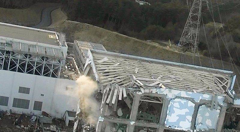

Astronuc:
IF the rods in the pool were perhaps not fully spent. . . for example, Unit 4 were shut down for maintenance, and all the fuel rod assemblies removed from the reactor core (and therefore removed from the primary containment) and IF, instead, they were in the SFP outside of the primary containment . . .
THEN, could loss of circulating coolant surrounding the rods in the SFP result in heat sufficient to boil off the remaining water, oxidize the Zr-2 cladding, generate steam + hydrogen + fires, burn through the floor and sidewall of the "dry" SFP, and "blow out" the side of the Unit 4 building?

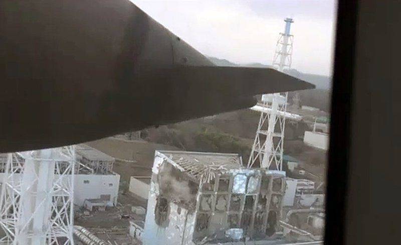

Look where the photo (I hope it was a remote robotic taking the picture) is centered. What do you think they were assessing? Does it look to you like there is a "slag-like" tongue of something hanging out of a relatively square hole in roughly the location that might correspond to the SFP, and that a sideways blast has taken out some of the structures external to the building as well as the roof of the building?
http://www.abc.net.au/reslib/201103/r735227_5964756.jpg
The damage from explosion at Unit 4 is fundamentally different than that at Unit 3, where all the structures seem to be blown out away from the primary containment.
  • #214
TCups said:
Astronuc:
The spent fuel pool (3) is outside of primary containment. It sits on top of the concrete structure. Each fuel assembly sits in a square tube in a rack. The rack has neutron absorber material to prevent criticality. The water covering the fuel provides cooling and shielding. The concern is that the water evaporates, and exposes the fuel to air. The oxgyen in the air then oxidizes the Zr-2 cladding, which produces hydrogen. The question then is what caused the fire at unit 4? If it was hydrogen deflagration (not an explosion) - then what is the source of the hydrogen? If there is no fuel in the reactor vessel - it may be that it is coming from the SFP, which has already dried out. Could there have been other sources of hydrogen? Perhaps if the plant uses hydrogen water chemistry. Could there have been other sources of fuel? If so, what?
If fuel is taken from the spent fuel pool and shipped out of the reactor building, it would be do so in a shielded cask, which is shown in the picture. The cask contains several assemblies (~28 perhaps), and it is filled with He for cooling. Even so, the casks can get pretty hot. Smaller shipping casks, which hold fewer assemblies, do not get as hot as storage casks. The oldest, coolest fuel is put in storage casks if there is insufficient room to store all discharged fuel + a full core's worth.
Units 1 and 3 had significant explosions, whereas unit 4 may have had a smaller explosion or fire. Or, was it damaged by the explosion and fire of unit 3?
I expect they are trying to assess the damage to unit 4 and how they might get water to the spent fuel pool.
