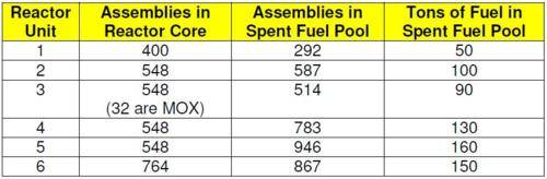

  • #265
Nuclear Energy Institute fact sheet on "Used Nuclear Fuel Storage at the Fukushima Daiichi Nuclear Power Plant," March 16, 2011.
http://resources.nei.org/documents/japan/Used_Fuel_Pools_Key_Facts_March_16_Update.pdf"
  • #266
So what is being reported now (that a basin has boiled dry) cannot have happened?
