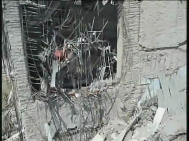

  • #2,851
TCups said:
I see the rails for the overhead crane as highlighted in red, and the large wench on the overhead crane as highlighted in yellow.
large wench ?
I suppose that's one way to get employees to work in high radiation zones!
  • #2,852
AtomicWombat said:
large wench ?
Sorry - I looked for an appropriate picture to illustrate, but I couldn't find one :blushing:

TCups said:
http://i306.photobucket.com/albums/nn270/tcups/Screenshot2011-04-04annotated.png
http://i306.photobucket.com/albums/nn270/tcups/Screenshot2011-04-04at50940PM.png
I don't think its a transfer chute but rather a pool. As far the rest of the picture is concern I've been trying to read the picture for a few hours and.. I'm not sure of what I'm seeing.
the video is conveniently cut from 13:22 to 15:xx

  • #2,859

  • #2,860
@Fred
Do you agree with the position of the crane? Do you think that thin line near the lateral margin of the crane is a short section of an arc? Do you think that jet of steam is under pressure? If those fit, then what other part of a pool comes that near the primary containment's plug other than the transfer chute?
There appears to be a label peeling off the side of the crane. Is that a clue that means anything to you?
PS: Fred - thanks for your feedback. I value your opinions.

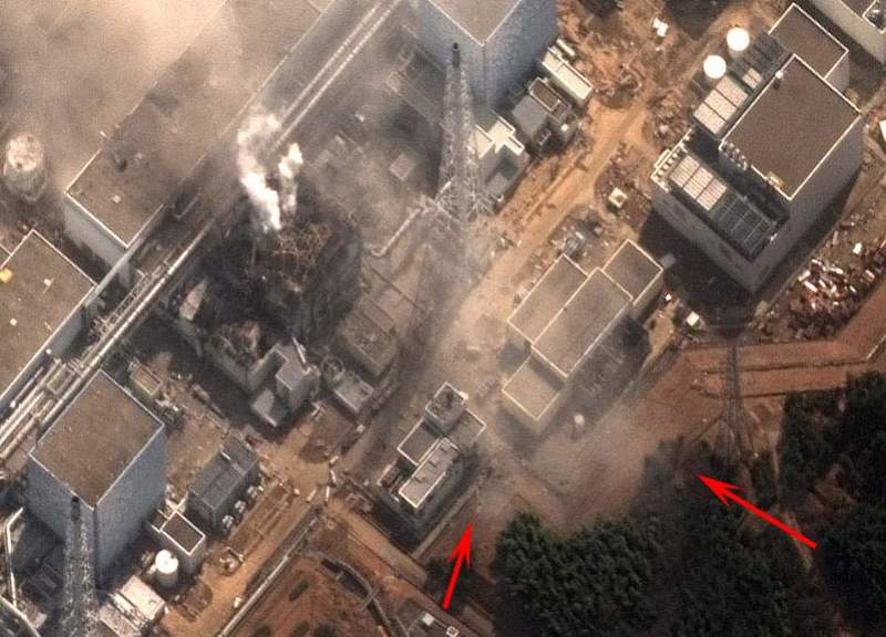

  • #2,862
http://en.wikipedia.org/wiki/Criticality_accident"
Accident types
Criticality accidents are divided into one of two categories:
* Process accidents, where controls placed to prevent any criticality are breached,
and
* Reactor accidents, where deliberately achieved criticality in a nuclear reactor becomes uncontrollable. Excursion types can be classified into four categories depicting the nature of the evolution over time:
and http://en.wikipedia.org/wiki/Chernobyl_disaster#Experiment_and_explosion"
...It was not possible to reconstruct the precise sequence of the processes that led to the destruction of the reactor and the power unit building, but a steam explosion, like the explosion of a steam boiler from excess vapor pressure, appears to have been the next event. There is a general understanding that it was steam from the wrecked channels entering the reactor's inner structure that caused the destruction of the reactor casing, tearing off and lifting the 2,000-ton upper plate, to which the entire reactor assembly is fastened. Apparently, this was the first explosion that many[who?] heard.[23]:366 This explosion ruptured further fuel channels, and as a result the remaining coolant flashed to steam and escaped the reactor core. The total water loss in combination with a high positive void coefficient further increased the reactor power.
A second, more powerful explosion occurred about two or three seconds after the first; evidence indicates that the second explosion resulted from a nuclear excursion.[24] The nuclear excursion dispersed the core and effectively terminated this phase[clarification needed] of the event...
http://www.youtube.com/watch?v=T_N-wNFSGyQ"
Listen to the link. Maybe: The first explosion (hydrogen ignites?) voids the atmosphere and causes water to flash to steam across the reactor and then sounds like it happens again, each with it's own explosion and the final sound you hear in the heavy crossbeam hitting the desk with a resounding metallic thud and deep ringing. [edit: disregard hearing the beam land, it's localized background noise the mike picked up, I think)
No go zone, massive release of contamination at this time, then the company later states they will probably never be able to approach Unit 3.
  • #2,863
|Fred said:
I don't think its a transfer chute but rather a pool. As far the rest of the picture is concern I've been trying to read the picture for a few hours and.. I'm not sure of what I'm seeing.the video is conveniently cut from 13:22 to 15:xx
Your right . Its the smaller pool on the right side of reactor if your looking at it from turbine building . Move left reactor that is leaking steam around it then main spent fuel pool on far left . I have a over flight video on my computer and have lined up the remaining beams and found the place in the photo . Unit 4 has a smaller spent fuel pool on right side so my guess is the layout is the same for Unit 3 .

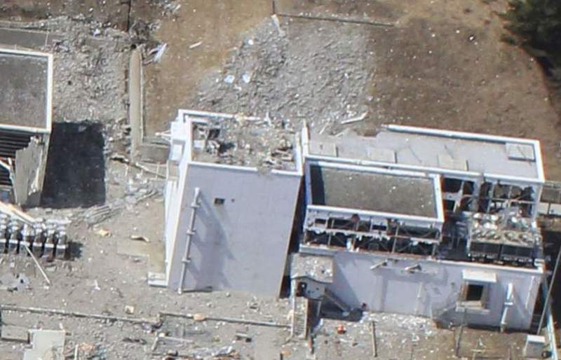

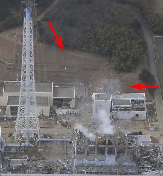

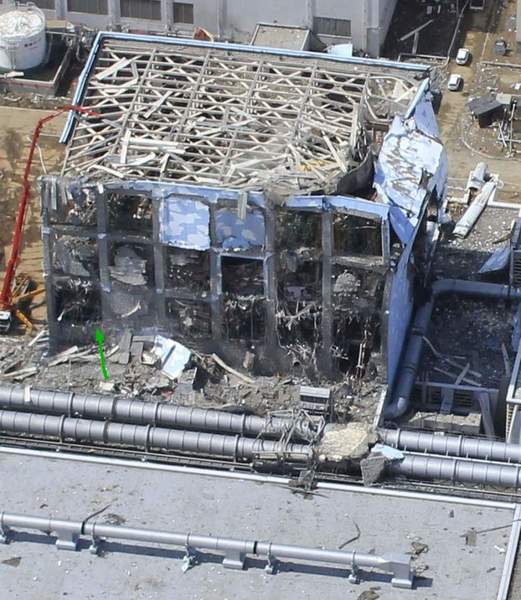

  • #2,864
A – Unit 3 turbine building containing the main turbine, main generator, condenser, condensate pumps, and condensate booster pumps. Roof damage possibly caused by debris from the Unit 3 reactor building (B) explosion
B - Unit 3 reactor building with extensive damage caused by hydrogen explosion
C – Unit 2 offgas line that transports air pulled from the condenser inside the Unit 2 turbine building during normal operation to the offgas building for treatment to reduce radioactivity levels before discharge to the atmosphere
D – Unit 3 offgas line that transports air pulled from the condenser inside the Unit 2 turbine building during normal operation to the offgas building for treatment to reduce radioactivity levels before discharge to the atmosphere
E – Unit 3 reactor building (B) exhaust line to the stack showing extensive damage
F – Unit 3 truck bay used to deliver canisters of new fuel assemblies into the reactor building (B) and its refueling floor
G – Unit 3 access hatch connecting the truck bay elevation with the refueling floor elevation inside the Unit 3 reactor building (B)
