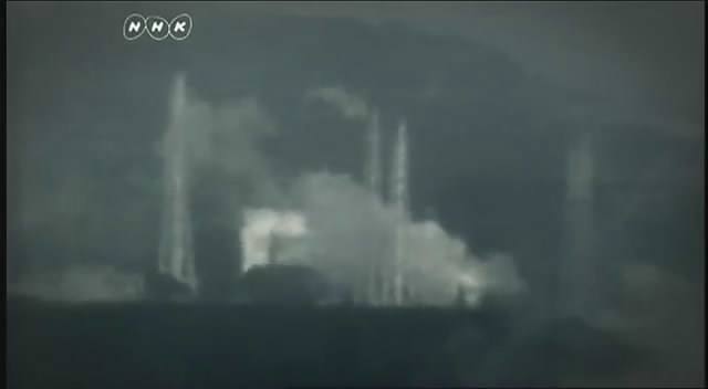

Excellent diagrams.
Can't find with sound but from this vid the vertical pressure wave does follow the first blast.
Zoomed in at 35 seconds.

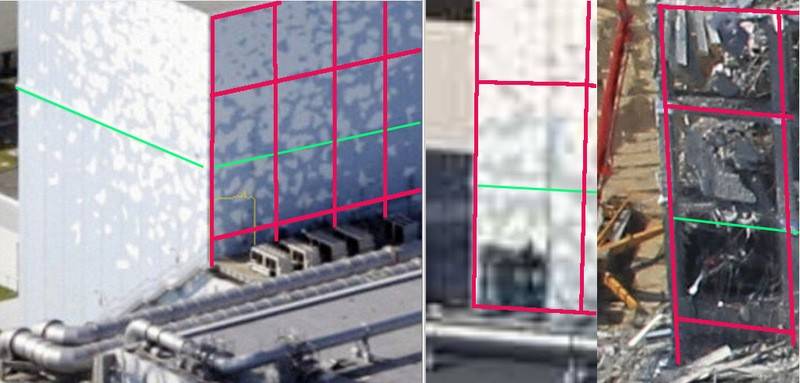

|Fred said:
Thank you Tcups, I'm glad to contribute to the collective quest for plosive answers that you lead for a fair amount .
There is one thing that I'm still not to confident with :
What are we seeing bellow the arrows It is supposed to be a strait wall.. How do we explain what we are seeing ?
[PLAIN]http://i.min.us/ikEmCk.jpg[/QUOTE]
Well, we are looking down at the equipment pool, essentially a straight-walled rectangular pit. The wall at the far end of the pit is where it interfaces with the reactors top area. This wall appears bright at the top, and darker below, your upper arrows points approximately to where the color changes. The bright part I interpret as some concrete top slab, designed to fit into the concrete slabs that lies on top of the reactor, and below other slabs, vertically jigsawed together, so to speak to form a wall. Several objects have fallen into the pit, most conspicous is a huge rectangular slab, which is leaning across the pit from the bottom left wall, and almost to the top right wall. it can be seen as a grey object just below your lower arrow. I looks to me as a kind of gate that fits in at the far wall, covering the slabs
Two additional things to note from those images. The location of the steam appears heavily discoloured black (on the beam). This is visible on the later clip where no steam is venting.
Secondly, on the side opposite the location of the red arrows, there is seemingly a void where the main floor slab has been blown out, or collapsed in. At least, that's how I read it given my assumption there were no openings in the floor on either side of the SFP delivery channel.
/edit : From the angle the image is taken, the black area should be the outside wall of the containment vessel in shade. Surprised it's SO black considering it's proximity to the opening giving us the view through along with enough daylight to provide some illumination.

ceebs said:
No it's not added in, that was the sound on the live coverage, its just never been repeated as far as I know since.
You explain to everyone how the sound traveled so far that fast . Camera was miles away . Sound does not travel that fast .
My only explanation is that the camera is not as far away as was reported, the film is that which was transmitted on the night, I had Sky on the TV and NHK on the laptop, and was watching to see if there was a difference in coverage between local and foreign media. The showing of that chunk of film with sound was far too soon after the explosion for anyone to have inserted fake explosion sounds onto it.
Perhaps the blasts occurred prior to the visual emergence of the fireballs and ejection of debris.

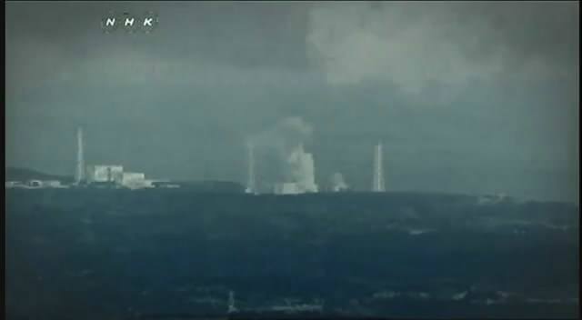

The quick release of energy would be an explosive expansion of the phase change of water to steam. Almost like a boiler exploding, maybe?
And is it the consensus that the FHD actually did go ballistic? I am not sure that has been independently confirmed, so as yet, that is just the best interpretation of the visual evidence, but not a proven fact, right?
As for the pressure inside the drywell and inside the RPV, I have not examined that data. I will have to defer to you or others on that point, Fred. I am not sure I follow the tabular data above. What is the 99999 figure? Is that absolute or relative pressure?
Were starting with superheated water (like a glass of pure water heated in a microwave). If a (relatively) small leak (re: failure at seal of cap) blew out sideways through the transfer gate, there would be a sudden rapid expansion of volume in the remaining liquid. The pressure would increase so rapidly that any other weak point, including an overstressed torus could give way.
99% steam?

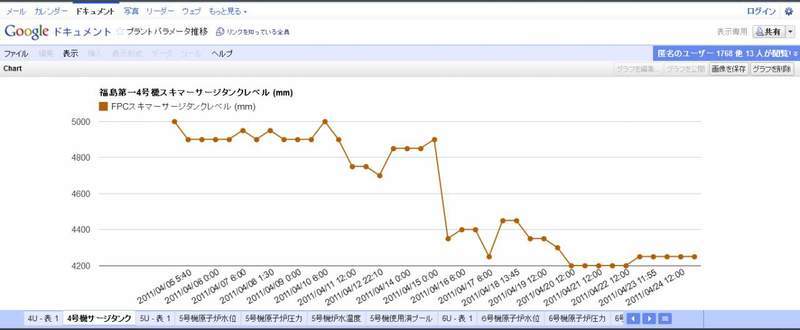

|Fred said:
I interpret the 99999 as nodata a way of inserting an event in the graph
Right. Sometimes the 99999 is a TEPCO fax that says "no data" for that variable, sometimes it is some other source (like an explosion report) that does not mention the variable.
The "Main.html" page in that directory has more details on the file format.
99% steam?
Notice the apparent color of the plume in this boiler explosion. :http://www.google.ca/url?sa=t&sourc...ElT6Rt4Wg&sig2=Mkl-1gUSN-BzZPjk4Gd9fQ&cad=rja

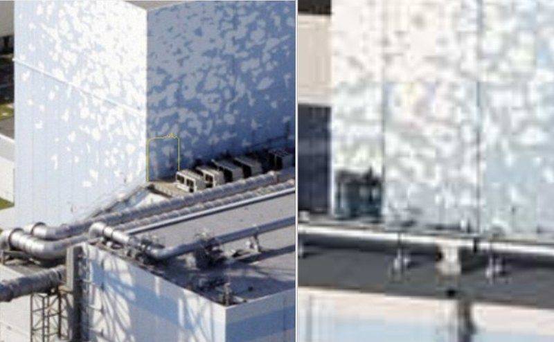

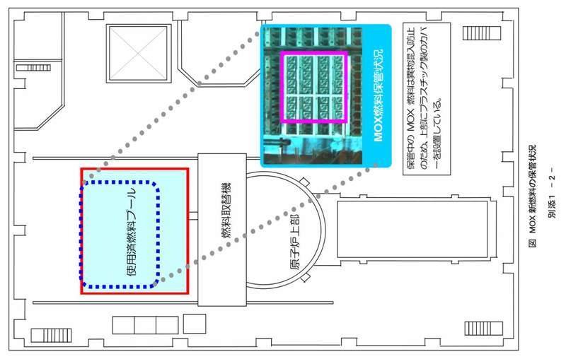

TCups said:
... I don't know if that makes perfect sense, but it is all I can conceive to put enough kinetic energy under the FHM. ...
Ballistic fuel handling machines is one of the most creative, out of the box and enetretaining thoughts on this forum.
However, it may just have been parked at the other end of the building, examine at below pics and from the rails on floor one can note that the machine can traverse the building north south or at least such that it can serve all the reactor in the center.
Furthermore, I presume that you will not want to park the FHM over the SFP , that way you minimize the FHM exposure to radiation from the open pool top, so that it does not slowly get radioactive.
[URL]http://posterous.com/getfile/files.posterous.com/billwarner/gbUyXtvgp1FtEJh42PIxIQmyui6J4AkDQt4VonEvEsdqT4673jaZvS2el9eL/rflg-fl2.jpg[/URL]
[URL]http://posterous.com/getfile/files.posterous.com/billwarner/CCk6zJXe49Enj3Fop4ELpKsth2FfRdpaNRMXPGCueXDaGxArPngCOWgWAsA3/rflg-fl1.jpg[/URL]

You could be right. At the end of the day, I will never be able to prove or disprove what I have proposed, so it is (or has been), most likely, a gigantic waste of time or effort. Maybe it was just hydrogen exploding upstairs. That's what all the news media say.
So, for now, I will just leave it at that and sit back and listen for a while. I am woefully behind anyhow.
Later.

Joe Neubarth said:
Note, that was a Carbon Fuel Burning Boiler. More than likely tubes with hot water on the inside and carbon dust on the outside where the flames of combustion are. When the tube bursts it kicks up a lot of carbon soot (and probably put the fire out).
Sure, I agree. But a super rapid steam (expansion) explosion would be carrying a lot of debris like concrete...
