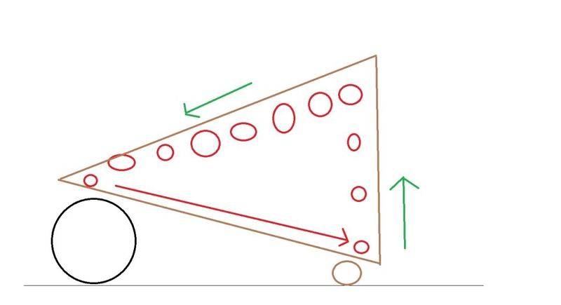

ok, i am not good at expressing i guess
but i apply what i just learnt
the GREEN arrow is a machine that brings the RED rollers up and downwards(SLOW)
the RED rollers will roll down the ramp due to gravity(FAST)
this would work right? the system would move to the left with friction blocking the right(slow) movement.
so now if i made the ramp very long and with a lot of rollers, i would achieve a great distance but i need a machine right?
will this work?
https://www.physicsforums.com/showthread.php?t=523300
With friction and uneven movement of the rollers, yes, it can work, but it's just an extremely inefficient way to push from the ground.
Um. Really hard to say.
There are more efficient ways to do this.
First, put ratchets on your wheels, preventing them from going any but one direction.
Then, put pretty much any vibratory, shaky device on your platform.
Cellphones have a little flywheel that's off balance. That will do. As long as the lateral movement is larger that the teeth on your ratchets.
