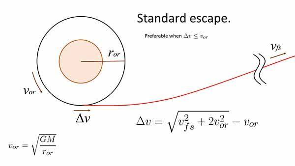

which brings us to our derivation of the standard escape equation in Figure 103.
[Figure 103: Standard escape equation]
We know that eventually, when the ship is far away from the moon/planet, and traveling at its final, free-space velocity, [itex]v_{fs}[/itex] that its potential energy has dropped to zero. So in the end, the ship's total energy is all kinetic energy. Its initial (normalized) potential energy is simply [itex]-\frac{GM}{r_{or}}[/itex]. But what we don't know yet is its initial kinetic energy immediately after the burn. We know that before the burn, its orbital velocity is [itex]v_{or}[/itex]. Immediately after the burn, its velocity is [itex]v_{or} + \Delta v[/itex].
So we apply conservation of energy. We know that the ship's total energy is the same immediately after the burn as it is when the ship eventually reaches its final speed, [itex]v_{fs}[/itex].
[tex]\frac{1}{2} v_{fs}^2 = \frac{1}{2} \left( v_{or} + \Delta v \right)^2 - \frac{GM}{r_{or}}[/tex]
Substituting [itex]v_{or}^2[/itex] in for [itex]\frac{GM}{r_{or}}[/itex] gives
[tex]\frac{1}{2} v_{fs}^2 = \frac{1}{2} \left( v_{or} + \Delta v \right)^2 - v_{or}^2.[/tex]
Multiplying by 2 and rearranging produces
[tex]\left( v_{or} + \Delta v \right)^2 = v_{fs}^2 + 2 v_{or}^2.[/tex]
And with a touch more algebra we find,
[tex]\Delta v = \sqrt{v_{fs}^2 + 2 v_{or}^2} - v_{or}[/tex]
which is the standard escape equation.
Note that when we take the derivative of [itex]\Delta v[/itex] with respect to [itex]v_{or}[/itex] and set that equal to zero, we find a minimum at [itex]v_{or} = \frac{v_{fs}}{\sqrt{2}}[/itex]. Plugging those back into our equation, we find that that minimum is [itex]\Delta v_{min} = v_{or} = \frac{v_{fs}}{\sqrt{2}}[/itex].
What that implies is that there is an optimal, orbital height for your ship to escape, if you are using the standard escape strategy (a single burn to escape). Assuming that you already know your final escape speed, the optimal orbital radius (for a circular orbit, and one you plan to use a standard escape with) is
[tex]r_{optimal} = 2 \frac{GM}{v_{fs}^2}[/tex]
Of course, KSP doesn't display orbital height in terms of radius to the center of the planet/moon. Rather it displays it as height above sea-level. So if you want to go by the height that KSP displays, you need to take the radius of planet/moon into account. Doing that gives
[tex]h_{optimal} = 2 \frac{GM}{v_{fs}^2} - r_{planet}[/tex]
where [itex]r_{planet}[/itex] is the radius of the moon/planet.
For every given planet or moon, you can find its radius and its standard gravitational parameter GM on the KSP wiki: http://wiki.kerbalspaceprogram.com/wiki/Main_Page.
You know that you have it right if you create a maneuver node in your present, circular orbit, for your desired destination, and the Δv displayed on the maneuver node equals (or nearly equals) your present orbital speed.
But what if you don't yet know your desired [itex]v_{fs}[/itex]? That's okay, you can calculate it. Create a maneuver node to your desired destination and jot down the Δv and your present orbital speed, [itex]v_{or}[/itex]. Then solve,
[tex]v_{fs} = \sqrt{ \left( v_{or} + \Delta v \right)^2 - 2 v_{or}^2}[/tex]
There's some serious implications to all of this. I've heard it said that "Minmus makes a great place to put a refueling station because it is near the edge of Kerbin's SOI, making it easier to escape." Ahh! No! That makes it a horrible place to put a refueling station, if you plan to escape the Kerbin system using the standard escape strategy.* With a standard escape, you'll use less fuel escaping if you start from a lower orbit.
*(There is one exception to this: asteroids. Asteroids travel in nearly the same orbit as Kerbin, so the ship's [itex]v_{fs}[/itex] is almost zero, with respect to Kerbin. So yes, a Minimus output would work quite well for asteroid redirect missions. But that's about it, if you limit yourself to standard escapes. On the other hand, if you want to use the fancy-shmancy escape, Minmus has advantages because it is so high above Kerbin. More on that in the next post.)
And, when using the standard escape, the ideal orbital height is closer to Kerbin, the farther the destination is, orbital wise. Putting it another way, the greater [itex]v_{fs}[/itex], the optimal orbital height is lower, all else the same (assuming standard escape).
If you work out the math, you'll find that the Mun would make a great place for a refueling station for the purpose of going to Duna, using a Hohmann transfer to Duna (Minmus is way to high for a standard escape to Duna). For planets that are farther way than Duna, even the Mun is too high for an optimal, Direct escape. So for planets beyond Duna, either put your refueling stations in a lower Kerbin orbit, or be prepared to do the fancy-shmancy via Kerbin, on the way out of the system.
The things to take home with you regarding the standard escape are:
  • There is an optimal, orbital height for entering and leaving a system for a given [itex]v_{fs}[/itex], when using the standard arrival or standard escape (single burn). This is great place to park massive service modules and massive refueling stations. Parking massive service modules/refueling stations in other orbital heights, either higher or lower, will require the ships to burn more fuel on arriving and escaping, assuming the standard arrival or standard escape (single burn).
  • This optimal height is dependent on the destination. More correctly, it is dependent on the [itex]v_{fs}[/itex] needed when escaping the system. (Assuming that the same type of orbit is used on arriving, the arrival [itex]v_{fs}[/itex] should be the same as the escape [itex]v_{fs}[/itex], btw.) And of course it is also dependent on the standard gravitational parameter, GM, of the moon/planet you are orbiting.
  • All that said, there is the potential to save even more fuel by parking in yet higher orbits, if you use the fancy-shmancy arrival/escape, which we'll talk about in the second half of the intermission.

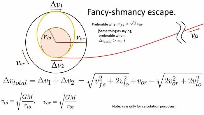

The fancy-shmancy
[Figure 104: Fancy-shmancy escape equation]
It's a pretty straightforward derivation if we first derive the Δv of each burn individually, and invoke Newton's vis viva equation.
We know that the ship's velocity immediately after the first burn is [itex]v_{or} - \Delta v_1[/itex]. Just after the first burn, the ship's path is elliptical, with the major axis equal to [itex]r_{or} + r_{lo}[/itex]. The ellipse's semi-major axis is half that, making [itex]a = \frac{r_{or} + r_{lo}}{2}[/itex]. Plugging those into the vis viva equation at apoapsis gives
[tex]\left(v_{or} - \Delta v_1 \right)^2 = GM \left( \frac{2}{r_{or}} - \frac{2}{r_{or} + r_{lo}} \right).[/tex]
Next we can make a few substitutions, to express the equation into their circular orbit velocities, instead of their radius counterparts, by noting,
[tex]r_{or} = \frac{GM}{v_{or}^2}, \ \ r_{lo} = \frac{GM}{v_{lo}^2}.[/tex]
Keep in mind that [itex]v_{or}[/itex] and [itex]v_{lo}[/itex] are not the velocities of the ship at apoapsis and periapsis of the ship, when this ship is in this elliptical orbit. Rather those represent the velocity the ship would have if the ship was orbiting at either of those radii, in a circular orbit. We're representing things in terms of those velocities since they are easy to calculate, and even easy to measure directly.
Making the substitutions,
[tex]\left(v_{or} - \Delta v_1 \right)^2 = GM \left( \frac{2 v_{or}^2}{GM} - \frac{1}{GM} \frac{2 v_{or}^2 v_{lo}^2}{v_{or}^2 + v_{lo}^2} \right)[/tex]
and simplifying
[tex]\left(v_{or} - \Delta v_1 \right)^2 = 2 v_{or}^2 - \frac{2 v_{or}^2 v_{lo}^2}{v_{or}^2 + v_{lo}^2}[/tex]
and more simplification on the right hand side,
[tex]\left(v_{or} - \Delta v_1 \right)^2 = \frac{2 v_{or}^2 \left( v_{or}^2 + v_{lo}^2 \right)}{v_{or}^2 + v_{lo}^2} - \frac{2 v_{or}^2 v_{lo}^2}{v_{or}^2 + v_{lo}^2} = \frac{2 v_{or}^4}{v_{or}^2 + v_{lo}^2}[/tex]
and taking the square root,
[tex]v_{or} - \Delta v_1 = \sqrt{\frac{2 v_{or}^4}{v_{or}^2 + v_{lo}^2}} = v_{or}^2 \sqrt{\frac{2 }{v_{or}^2 + v_{lo}^2}}[/tex]
thus
[tex]\Delta v_1 = v_{or} - v_{or}^2 \sqrt{\frac{2}{v_{or}^2 + v_{lo}^2}}.[/tex]
Keep that one handy. We'll come back to that.
But first, as an intermediate step, we need to find the ship's speed at periapsis. Let's call it [itex]v_{peri}.[/itex] And for that, the vis viva equation comes to the rescue again. The set up of the right hand side of the equation is the same as last time, except now [itex]r = r_{lo}[/itex] rather than [itex]r_{or}[/itex].
[tex]v_{peri}^2 = GM \left( \frac{2}{r_{lo}} - \frac{2}{r_{or} + r_{lo}} \right)[/tex]
Making the same substitutions as before, and the same sort of simplifications,
[tex]v_{peri} = v_{lo}^2 \sqrt{\frac{2}{v_{or}^2 + v_{lo}^2}}.[/tex]
Recall the orbital energy equation,
[tex]\epsilon = \frac{1}{2} v^2 - \frac{GM}{r}.[/tex]
We can invoke conservation of energy again here. The left hand side of the equation below is the energy when the ship is far, far away from the planet/moon, and the right hand side of the equation is immediately after the second burn.
[tex]\frac{1}{2}v_{fs}^2 = \frac{1}{2} \left( v_{peri} + \Delta v_2 \right)^2 - \frac{GM}{r_{lo}}[/tex]
Making our standard substitution,
[tex]\frac{1}{2}v_{fs}^2 = \frac{1}{2} \left( v_{peri} + \Delta v_2 \right)^2 - v_{lo}^2[/tex]
Solving for [itex]\Delta v_2[/itex] gives
[tex]\Delta v_2 = \sqrt{ v_{fs}^2 + 2 v_{lo}^2} - v_{peri}[/tex]
And finally making the [itex]v_{peri}[/itex] substitution from what we calculated earlier,
[tex]\Delta v_2 = \sqrt{ v_{fs}^2 + 2 v_{lo}^2} - v_{lo}^2 \sqrt{\frac{2}{v_{or}^2 + v_{lo}^2}}.[/tex]
Now we can combine our [itex]\Delta v_1[/itex] and [itex]\Delta v_2[/itex] to make our [itex]\Delta v_{total}.[/itex]
[tex]\Delta v_{total} = \Delta v_1 + \Delta v_2[/tex]
[tex]= \sqrt{v_{fs}^2 + 2 v_{lo}^2} + v_{or} -v_{or}^2 \sqrt{\frac{2}{v_{or}^2 + v_{lo}^2}} -v_{lo}^2 \sqrt{\frac{2}{v_{or}^2 + v_{lo}^2}}[/tex]
[tex]= \sqrt{v_{fs}^2 + 2 v_{lo}^2} + v_{or} - \left( v_{or}^2 + v_{lo}^2 \right) \sqrt{\frac{2}{v_{or}^2 + v_{lo}^2}}[/tex]
And one last simplification yields,
[tex]\Delta v_{total} = \Delta v_1 + \Delta v_2 = \sqrt{v_{fs}^2 + 2 v_{lo}^2} + v_{or} - \sqrt{ 2 v_{or}^2 + 2 v_{lo}^2 }[/tex]
And remember, [itex]v_{lo}[/itex] can either be calculated using [itex]v_{lo} = \sqrt{\frac{GM}{r_{lo}}}[/itex], or directly measured. It's likely that at some point or another, you will have a ship in low, circular orbit around the planet/moon in question. Simply jot down its orbital velocity while it's in that low, circular orbit, and that's your [itex]v_{lo}[/itex] that you can use later, if you wish to do fancy-shmancy escape calculations.
A couple of final things:
  • Note that this equation does not have a local minimum. Instead, [itex]\Delta v_{total}[/itex] keeps getting smaller for higher orbits, eventually settling out at [itex]\sqrt{v_{fs}^2 + 2 v_{lo}^2} - \sqrt{2} \left(v_{lo} \right)[/itex], for extremely high orbits.
  • When [itex]v_{or} = \frac{v_{fs}}{\sqrt{2}}[/itex], the total [itex]\Delta v[/itex] is the same as the standard escape. So for orbits lower than this critical value, use the standard escape. For higher orbits, use this fancy-shmancy escape if you wish to save fuel.
