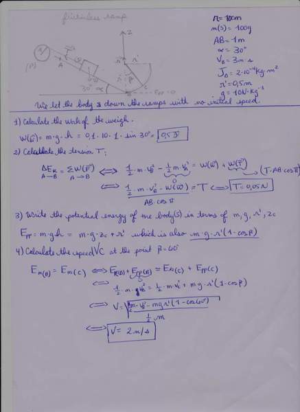

Look at the attachment
Please tell me if there is anything wrong with my work because apparently my teacher thinks its wrong.

Can you please state the problem and what you are asked to find?
1. calculate the work of W.
2. calculate the tension or w.e its called of T.
3. a/ write the potential energy in terms of m,g,r',and Zc
b/ find the speed of the body (s) at the point β=60°
sorry I'm learning this stuff in a different language so I'm just translating it by myself.
I'm a bit puzzled by the problem. You are given both the distance traveled and the speed at point B? (Seems like you should be able to calculate the speed given the distance.)

yea i did solve it and it came out to 2m/s and everything else is correct and i don't know how my teacher thinks its wrong.

I did not solve for the speed myself, but it seems as if you're saying that it comes out to be 2 m/s. Yet on your sheet it seems to be given as 3 m/s. Something's wrong somewhere.
Did the statement of the problem include the speed at point B?
No that speed is for when the body is at the point B. We have to find the speed of it when it's at point C.

Once again I ask: Are you given both the distance AB and the speed at point B? (If so, you should check that the speed at B is correct by solving for it directly.)
Yes i am given AB=1m and Vb=3m/s but the question was to find the speed at the point C.
And i used the law of conservation of mechanical energy to solve for the speed at the point c and i got 2m/s. You are given 3m/s just so you use it to solve for c.

no man i don't need the speed at the point b i need the speed at point c where i found it to be 2m/s. I don't know why you guys think i need to find the speed at b. I was given that stuff on the top right corner of the paper.

Did you check that Vb = 3 m/s is correct? My point is that given AB = 1m, you should be able to solve for Vb. They shouldn't have to give it to you.

Ok i'll check the speed at b right now and we given the speed at the point b so we can use it to find the speed at c and is my speed for c correct?
Assuming that the speed at B is correct, then the speed you calculated for point C seems correct to me.
i found the speed at b is 3.16m/s but he gave it to us as 3m/s.
Yea that's all i wanted to know, he just counted it wrong for me for no reason.
