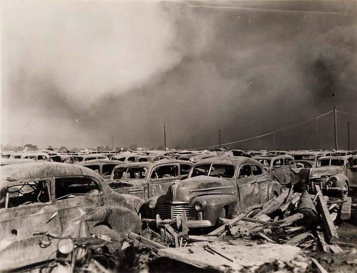

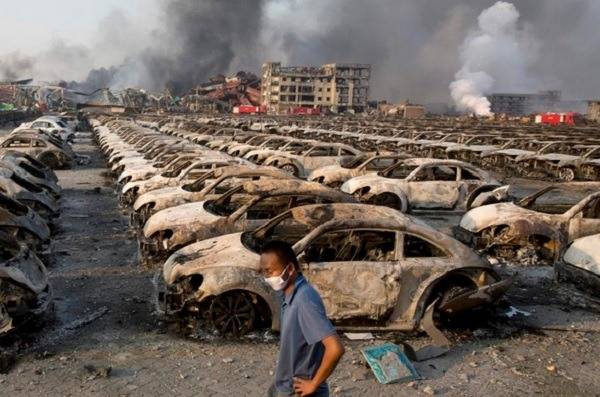

This photo of a new car lot gives some idea of the blast effect. Every single vehicle identically destroyed with all glass windows blow out(in?), tires burned off, up to ~1/2 mile away.
See the similarities between vehicles nearby the Texas City 1947 amonium nitrate explosion (hat tip Astronuc)
I thought the same thing when I saw the pictures of the cars in Texas City and the lot of cars in Tianjin.

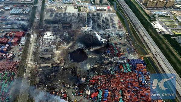

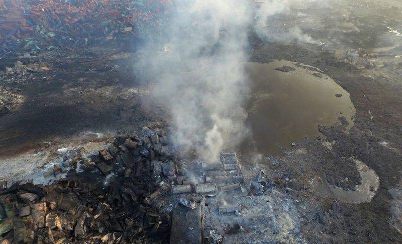

Bystander said:
No crater.
Haven't seen ground zero yet? I think those are cargo containers.
