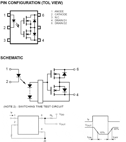

Since I already have a USB I/O device for the 0-5V analog control (measurementcomputing*dot*com USB-1208LS) capable of sourcing 30mA, I figure that a solid-state relay should work.
Berkeman, the one you've recommended is unfortunately not an in-stock item and I'm betting I'd need to order more than one. I did, however, find an alternative photorelay that i think will work:
Toshiba TLP3542. Since I can't link to it, here are relevant specs:
1.33VDC input
10-20mA forward current
0-2.5A load
0-60V load
Attached are a couple diagrams of the chip and testing circuit from the datasheet. So am I right in thinking that in order to use this chip, I would need to:
1) attach the 0-5V analog output from the PC I/O board to pin 1
2) attach the ~3V, 1A source to the red wire to the diode laser
3) attach the black wire from the diode laser to pin 6
4) Tie pins 2 & 4 together, and ground them to both the ground on the PC I/O board and the power source for the laser
Sorry to be asking again, but I just want to make sure that I have this right before I attempt!

Looks like a better choice than the one Berkeman found.
The TLP3542 has a higher current rating and your 1.4 amp requirement was kind of close to the max rating of the other part.
Edit: Verify that the max turn on turn off time will fit your requirements. It should but it's somewhat slower than the part Berkeman suggested.
To wrap up this issue, this is my implemented successful solution:
I had a power MOSFET sitting around the lab, and did a bit of research on it (IRFZ44N). It has a lot more capability than I need:
+-20V gate voltage
+-50V drain-source voltage max
49A max drain-to-source current
Perfect. Since I'm running a variable current & variable voltage power supply, I simply set a max. of ~3V, 1.2A and used the analog output (4.5V to overcome the threshold voltage) to switch on and off.
Absolutely perfect for a very fast, low leakage current voltage controlled current source. Plays nicely with Matlab :-P
