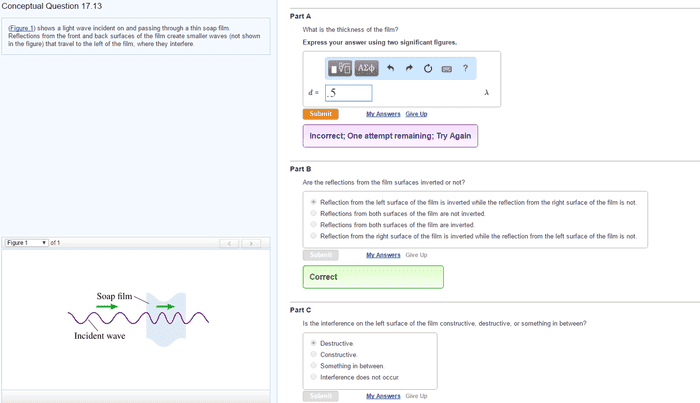

Light wave incident on and passing through a thin soap film
The discussion revolves around calculating the thickness of a thin soap film using the equations thickness = (m)(lambda)/(2nf) and thickness = (m+1/2)(lambda)/(2nf). There is a concern regarding the provided values for wavelength and refractive index, which are essential for accurate calculations. The requirement for the answer to be expressed in two significant digits is highlighted, as only one significant digit was given. Additionally, there is a question about the units of thickness and whether it is expressed in multiples of lambda. Accurate calculations and adherence to significant figures are crucial for obtaining the correct thickness of the soap film.
tffnyyy
here is the problem. i got 0.5 from the fact that thickness = (m)(lambda)/(2nf)
other equation for thickness is thickness = (m+1/2)(lambda)/(2nf)
It seems that you have value for the wavelength and or refractive index? Note also that they want the answer to two significant digits where you only supplied one. What are the units of d? Is it multiples of lambda? I notice that there is a lambda to the right of the answer?
