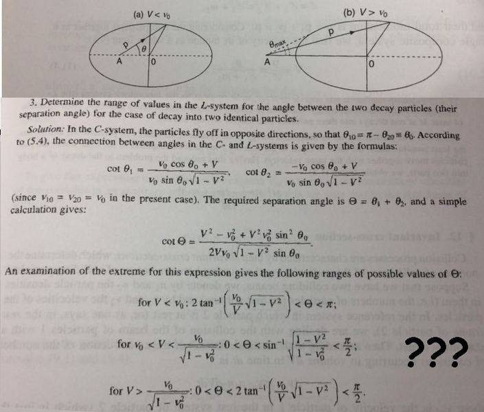

The one in the middle with cot (big tetha)
I have no ideea how he finds the limiting cases for V<v0; v0<V and for V> v0/sqrt (1-v0^2) .
The problem is from Landau course for theoretical physics, volume 2: The Classical Theory of Fields. page 35.
I have been struggling with this problem for quite some time but made no real progress. Any bit of advice or even a full derivation step by step would be much appreciated. Is not a homework in the real sense btw. Thank you.
What is the independent variable for finding the extrema of
I would say the independent variable is tetha_0 since for each case we set V and V0 constant.
Yes. Did you try finding the extrema of the right-hand side of the cotΘ expression?
