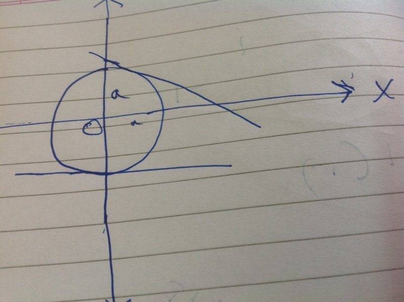

Took a point on line x1,y1
Then slope is - x1/y1.
x12 + y12 = a2
Also hx1 + ky1 = 1.
Here is a circle of radius a and some random 2 tangents drawn.
Good start. The point where the line is tangent to the circle is (x,1y1).
Now (important step): what's the equation of the line ? (I don't mean hx1 + ky1 = 1 but the equation for the line in therms of x1, y1 and a)

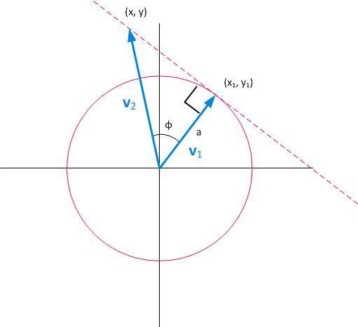

LIne segment from origin to (x1, y1) has length a.
Tangent line in (x1, y1) is perpendicular to that line.
That means all points (x,y) on that tangent line satisfy $$ (x_1,y_1)\cdot(x, y) = a^2$$ -- an inner product, written out : $$x_1 x + y_1 y = a^2$$ -- and there's your tangent line equation without any quadratic equation at all !
Compare $$x_1 x + y_1 y = a^2 \quad {\rm to} \quad x + k y = 1$$ and you see
$$h = x_1/a^2 \quad {\rm and} \quad k = y_1/a^2$$
Since $$ x_1^2+ y_1^2 =a^2$$ you indeed find
$$ h^2+ k^2 =1/a^2$$
Have you ever heard of the normal equation for a straight line ? We learned it at school (I was 15 then...).
It goes like this:
For all points on the dashed tangent: Inner product $$(x,y) \cdot\ (x_1, y_1) = \vec v_1 \cdot \vec v_2 = |\vec v_1 |\;|\vec v_2| \;\cos\phi = |\vec v_1 |\;|\vec v_1|/ \cos\phi \;\cos\phi = |\vec v_1 |^2$$
Note that this time the arrows aren't for infinite lines but for vectors.
There is also a unit normal vector form: if ##\tan \alpha = y_1/x_1## (hey, that's like (-x_1/y_1) -1 !)
you have with ##\vec n = (x_1, y_1), \quad \hat n = (\cos\alpha, \sin\alpha) = (x_1, y_1) / |\vec v_1| ## that $$ x\cos\alpha + y\sin\alpha = |n| \quad {\rm or} \quad \vec v \cdot \hat n = |\vec n|$$

Very nice drawing! What software package did you use to draw it?
Thank you for the compliment; that was MS Visio.

Hey what angle ## \alpha ## is here in diagram?
I understood your dashed tangent inner product but not that unit vector normal form.
##\tan\alpha = y_1/x_1##
This unit vector normal form simply removes one factor ##|\vec n|##.
