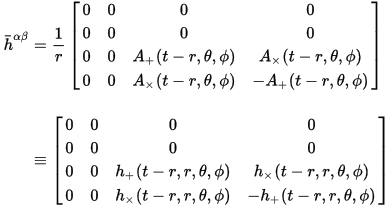

But you are mixing two different things here. The first situation is before you fix the transverse-traceless(TT) gauge, and there you have ##\bar{h}=-h##, otherwise why bother to use a trace reversed perturbation to be able to implement the Lorenz gauge condition if it is equal to the perturbation tensor?, second step: after this, on top of the Lorenz gauge we fix the TT gauge for the vacuum case modelling of the perturbation as a plane wave solution. This is what LL calls ## \psi_{\alpha\beta}## and in this case indeed there is no trace, the metric perturbation is purely spatial now we are in the vacuum asymptotically flat case, and the former Lorenz gauge makes it also transverse, that's why they call it Transverse-traceless gauge, and of course ## \psi_{\alpha\beta}^{TT}=\bar\psi_{\alpha\beta}^{TT}##
So I guess you are not calculating right the appliccation of the Lorenz gauge to the TT metric, since it must meet it. Remember that only the cases with components xx and yy on one hand and xy, yx on the other are independent. You seem to be mixing xx and xy above.

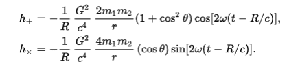

The strain at any time depends on ##\phi## as well as the time, but the amplitude of that sinusoidal variation depends only ##R## and ##\theta##.
##strain=A(R,\theta)sin(\omega t-2\phi)##
Of course that needs to be expanded for the change of polarisation with ##\theta##.
No, this isn't correct, because the strain is the amplitude. They're the same thing. (Technically, you could say that the strain is how we measure the amplitude, but that doesn't really make any difference for this discussion.)
This is a question of jargon but also I just realized the Wikipedia page has an error that is confusing. In the first line in the section on Wave amplitudes from the Earth–Sun system, it actually shows the equation for the strain (omitting ##\phi##) but lower down it shows the first part which I've always seen called the amplitude and the text (green box) seems to say the same but is a bit ambiguous.
The first part should say ##strain=h_+ cos(2 \omega(t-R/c)-2 \phi)## and then the definition of ##h_+## as the "amplitude" in the second red box is correct.

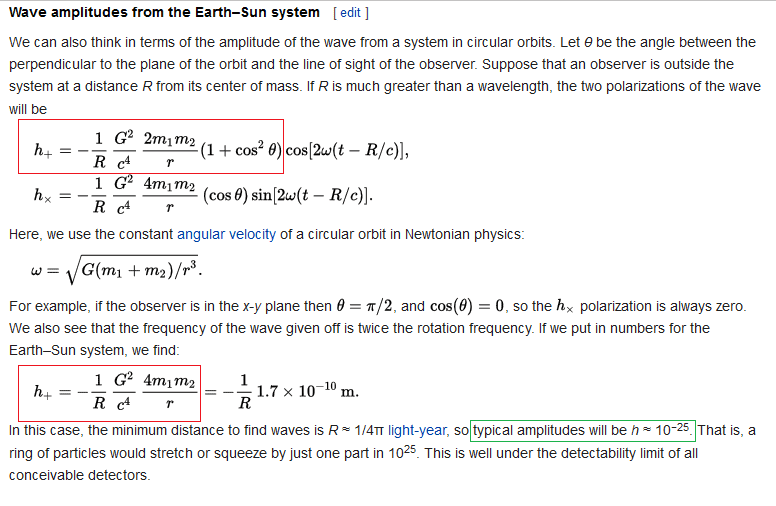

View attachment 104042In that section, the "equator" is described by as θ=π/2 : "For example, if the observer is in the x-y plane then θ=π/2, and cos(θ)=0, so the h× polarization is always zero.".
The original maths (which is beyond my level) is in the next section, Advanced Mathematics, and in particular the solution in spherical coordinates is given in Linear Approximation as
I won't pretend to understand that, but I assume the two simpler equations given earlier for the Earth-Sun system are derived from that, and it is those that I am illustrating. The sources quoted are Kip Thorne [71] and MTW [72].
There is a certain amount we can illustrate from these equations, but perhaps not the way you're doing it. I'll give you what I think I've figured out so far, along with the supporting arguments.Let's start with a pictorial representation of a plus polarized GW, from wiki.
Next, we note that following remarks from wiki:
wiki said:
For example, if the observer is in the x-y plane then θ = π / 2, and cos ⁡ ( θ ), the ##h_{\times}## is always zero.
So, to represent the GW at ##\theta = \pi / 2##, which I will henceforth term "the equator" (the equator being the equator of a 3d sphere drawn around the binary) we only need to represent a + polarized GW. And the above diagram does this - in a small region. The issue is, that we want to cover a large region. Any 3d map (or moving 3d representation, which would be a 4d map) in flat space-time cannot be to scale over a region larger than one wavelength of the GW. Here is where I feel that GeorgeDishaman's attempt at a representation fails and probably becomes actually misleading. The problem is that the 4d space-time is not flat, and it can't be represented to scale as if it were flat. We are pushing our intuition too far.

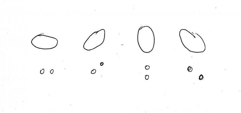

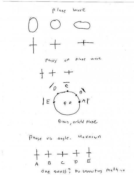

But there is a solution to this. We can't draw the whole picture to scale, but we can draw tiny parts of it to scale. So we can draw a bunch of small diagrams, represent small sections of the space-time geometry. And those will look just like the wiki representation above.
At this point, I'll introduce my quick sketches. (I hope this works right - there's some possibility I'll have to fixed the post):
[add: changing the file type worked]
The first part of the sketch is a pencil-and-paper drawing of the + polarized GW, the same as Wiki's moving dot representation, but just drawing the shap of the dots at different times. First I draw ellipses, then , because even that's hard to do, I stylize the ellipses with a pair of lines, representing the semi-major axis. One axis is longer than the other, which axis is longer and which axis is shorter represents the phase-state of the GW. You can think of it as a pictorial representation of the spatial representation of the ring of test masses.
We can imagine then, that we have a bunch of observers with Ligo's all located around what I've dubbed the equator of the binary pair, all detecting GW's and observing test masses move. Because no observer extends over too large a region, we do not run into the representation problems I mentioned earlier.
Now we see the information we are missing to draw a complete diagram of the GW. We know there are a bunch of + polarized GW's around the equatorial ring, and we know how to represent them. But what we don't know is the relative phase relationship, i.e. if we define a concept of "now" based on retarded time from the center, we don't know what phase the GW is at any point.
I have a guess as to what the phase relationship could/should be, but no supporting math at this point. In the later parts of my diagram, I've drawn 5 observers, which I"ve lablled A,B,C,D,E, all in a ring around the equator. Each one measures with their Ligo the GW's emitted by the binary, and takes a "snapshot" of the configuration of the test masses at the "same time" - as defined by the reception of a signal emitted from the center of the diagram. There will definitely be some set of such snapshots that represent the state of the system, but the phase of the snapshots (which axis of the ellipse is long, which is short) vs angle is not known from the wiki article.

On a related note, here's my sketch for what I think a GW detector mounted at one of the poles should observe. Here we have both + and x components of the GW, per the wiki article. The + wave will stretch the metric according to the + wave diagram from wiki, with a phase relationship of ##\cos 2 \omega (t-r/c)##, so that at t-r/c=0, the stretch in the + direction will be a maximum. The x component of the stretch will be proportional to ##\sin 2 \omega (t-r/c)##, so the peak stretch in the x direction will occur when the stretch in the + direction is zero.
The same style picture of this are below. Note that the diagram gives a false impression of rotation - there is no rotation, just stretching. Given thatwhen the + stretch is maximum, the x stretch is zero, and vice versa, I believe the result must look like this.
The test masses are always in an elliptical configuration, they're always stretched in at least one direction. Symmetry leads me to believe that the overall shape of the ellipse doesn't change (in the case where the orbiting binary has no eccentricity). So the only change in shape is that the major axis of the ellipse of the test masses rotates (though the test masses themselves don't rotate). There should be some phase relationship between the shape of the test masses and the position of the bodies in retarded time. I've sketched what i think is the probably relationship by drawing one below the other, but at this point the phase relationship is still speculative. I *think* it's clear that if we use retarded time t-r/c, there should be some fixed relationship between the major axis of the ellipse of the test masses as the orbital axis of the binaries, but perhaps I'm fooling myself.
That's spot on ;-) In my video version, the colour encodes the stretch so for example yellow for elongated round the equator and blue where it is compressed for the orbital plane version.
The logic that supports what you've drawn is straightforward. The pattern must be cyclical, it must repeat the same for every orbit provided we are considering the case a long time before merger hence when we have a constant orbital period. That also implies constant radius hence constant amplitude, technically the energy loss per orbit must be much less than the total orbital energy.
If we assume the binary masses are equal, then we can't tell if they switch places, the observed stretch/shrink pattern must be the same so there must be two maxima and two minima of stretching per orbit, that ties in with the quadrupole format. (It raises another question, if the masses were dissimilar, would there be a sub-harmonic in the waveform, a component at the orbital frequency? But that's for another day.)
The pattern seen by one observer when the binary is in some arbitrary configuration must also be seen by another observer farther round the equator but some time later hence the pattern must appear to rotate with the system.
The actual phase at any point cannot easily be predicted for a practical case, we know the distance to a source with an uncertainty of light years but the wavelength might be light minutes for a binary like HM Cancri or a fraction of a light second for GW150914.
P.S. Re your second message, that makes sense too, whatever the pattern is it has to stay constant and rotate with system. Each test mass however would be moving in a small circle around its mean position, not round the pole. The degree of distortion would be constant (constant colour) but the direction changes which is why I need to add something to the video.

GeorgeDishman said:
The first part should say strain=##h_+ cos(2 \omega(t-R/c)-2 \phi)##
Where are you getting that from?
Not if it's different from the "strain".
The "strain" is defined as the dimensionless change in the distance between neighboring geodesics, i.e., neighboring test masses that start out at rest relative to each other before the GW passes, and which are moving inertially, with no forces acting on them. To make the distance change dimensionless, we divide it by the original distance between the masses. So, heuristically, we have strain ##s = \delta d / d##, where ##d## is the original distance and ##\delta d## is the change in distance.
Now consider a pair of test masses separated by a distance ##d## along the ##x## axis of the coordinate chart in which the Wikipedia page equations are written. This distance is given in terms of the line element by ##d = g_{xx} \left( x_2 - x_1 \right) = \left( 1 + h_{xx} \right) \left( x_2 - x_1 \right) = \left( 1 + h_+ \right) \left( x_2 - x_1 \right)##. (This is just using the definition of ##h_+## as given on the Wikipedia page.) Before the GW passes, we have ##h_+ = 0##, i.e., ##g_{xx} = 1##, so we have ##d = x_2 - x_1##. Then, as the GW passes, we can write the change in ##d## as ##\delta d = \left( 1 + h_+ \right) d - d = h_+ d##, i.e., the distance using the new ##g_{xx}## including the GW effect, minus the original distance. This obviously means the strain ##\delta d / d = h_+##. In other words, the "strain" is the "amplitude".
What all this shows is that, as I said before, the Wikipedia page equation can't be using the same underlying math as the NASA image.
It's a convention I've seen in many papers on the subject, unfortunately there seems to be some ambiguity in the use of the symbol ##h##.
As example is a paper giving the estimated GW signal from HM Cancri which is expected to be the strongest verification signal for eLISA. The paper is here 2010 ApJ 711 L138 and section 4.3 says: "With the system parameters derived in the previous section, we can calculate the gravitational-wave strain amplitude at Earth. The distance to HM Cnc is the largest remaining uncertainty; it is probably ∼5 kpc based on the expected sizes and measured temperatures of the white dwarf components (Barros et al. 2007). This gives a dimensionless gravitational-wave strain amplitude ##h \approx 1.0 \times 10^{-22}##."
Here they are using ##h## for the amplitude of the sine wave strain, not the instantaneous value.
That is correct using the first definition on the Wikipedia page, the second definition of the same variable ##h_+## omits the time variation which is where the confusion arises.
The mains supply here in the UK is a voltage of ##v=325 sin(2 \pi f t)## where f is 50Hz and the amplitude is 230V r.m.s. or 325V peak. I believe it is common practice to use the same terminology for gravitational waves, the amplitude refers to the strain but omitting the time variation and it is usually the peak value rather than r.m.s. but unfortunately the symbol ##h## is commonly used for both.
