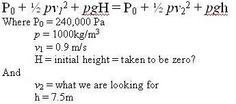

A water pipe having a 2.6 cm inside diameter carries water into the basement of a house at a speed of 0.90 m/s and a pressure of 240 kPa. If the pipe tapers to 1.6 cm and rises to the second floor 7.5 m above the input point, what are the (a) speed and (b) water pressure at the second floor?
I tried to set it up as:
But clearly it's wrong because I didn't take into consideration the area (given the diameter) etc.
I would appreciate any help. Thank you.
Oh, but to solve this problem you'll need to use your last topic equation (the continuity equation :wink: )
All righty...
if it's A1V1 = A2V2...do we take into consideration the final height?
