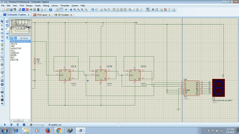

I have drawn my circuit in Proteus, and in the simulation it can run, but when i used GL 12 test board to test my circuit, it can't run. And i reallize that i don't know where is the ground in the test board. Can you guy tell me where is the ground ?

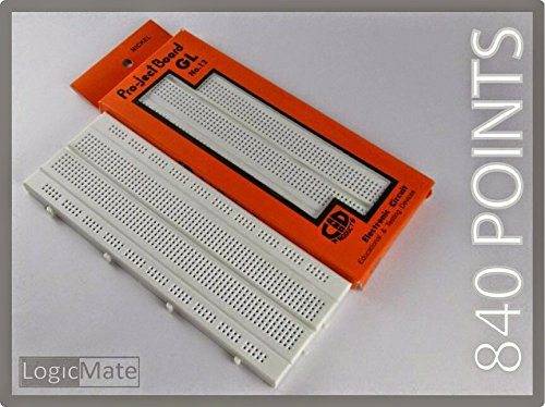

What's a GL 12 test board?
I think it might be a breadboard. Maybe like this one?
If so, the ground isn't ground until you make a connection to ground. You (@thuc) get to decide what is ground.
If you tilt the breadboard up so that the long dimension is vertical and the shorter dimension is horizontal, then in the middle of the board (adjacent to the large, central, vertical indentation), then there is a large array of x5 internal connections, one row on each side of the large indentation. That means that you can put a dual inline package (DIP) integrated circuit (IC) vertically along the center indentation, and you have 4 leftover squares for each pin for connections. On this area of the breadboard, the rows have internal connections bounded by the indentations.
On the vertical edges, the internal connections are along the columns (on the outside of the two, smaller, vertical indentations), not the rows. Each edge has internal connections that go along the entire column*. There are two, separate columns on the left side and another two, separate columns on the right side. Usually, you'll choose one column to be ground (GND) and another to be the positive voltage ([itex]V_{CC}[/itex] or [itex]V_{DD}[/itex]). But this is your choice.
*[Edit: on some breadboards, the internal connections only go down half-way along the columns. You can check this on your breadboard by looking at your breadboard's documentation, or by performing a continuity test.]
No connection is ground until you hook it up to the power supply and connect it so that it is ground.

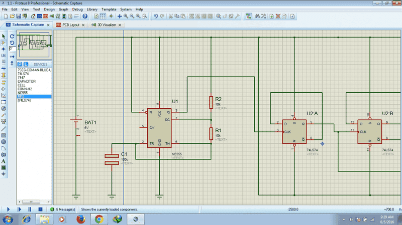

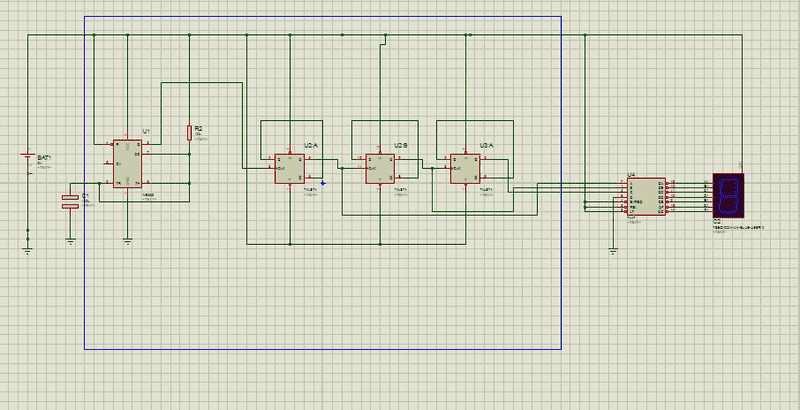

thanks for showing me guys, but i still don't understand why it doesn't work, i have checked it many times. Mine counter up consits of 1xNE555, 2x74LS74, 1x74LS47, 1x7segment LED 5101BS. and a source with 4 batteries.

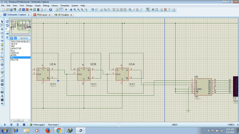

U1 shows VCC and GND are connected. How are U2 and U3 being similarly energized?
I notice in your 555 timer circuit that pins 6 (Trigger) and 7 (Discharge) are tied together (shorted) and both to ground through a capacitor. Pins 6 and 7 are also connected (shorted) with pin 2 (Trigger).
Shorting pins 6 and 7 together is typical when designing a one-shot (a "monostable" circuit that generates a single pulse -- one pulse, just one). Is that what you want to do for this circuit? [However, in a one-shot, monostable circuit, pin 2 is used as the trigger input. I don't see that in your circuit.]
To operate the 555 timer in "astable" mode (where it generates an oscillating waveform, like a clock circuit) a resister is typically used between pins 6 and 7. [In astable mode, pin 6 is connected to pin 2, typically. But not to pin 7.]
Could that have something to do with the problem? is the 555's output doing what you want it to do?
[Edit: In other words, if the resistor between [itex]V_{DD}[/itex] and pin 7 is [itex]R_A[/itex], and the resistor between pins 6 and 7 is [itex]R_B[/itex], then the duty cycle of output waveform is
[tex]D = \frac{R_B}{R_A + 2 R_B}[/tex]
In your circuit, [itex]R_B = 0[/itex], meaning the duty cycle is 0. Is that what you really want?]

Oh i forgot to mention: it's a counter down circuit, i want it to count from 7 to 0 repeatedly. I saw a guy on youtube had the pin 2 of 7474 connect to ground, can you tell me why ?

Pin 2 of the 74LS47? That's the A2 pin of the BCD decoder/driver.
I can understand why you might want to tie pin 6 (A3) to ground, since you're not counting numbers from 15 to 8, But I don't know why you would want to tie the A2 pin to ground (A2, A1 and A0 [often labeled C, B, A] are necessary for numbers 7 to 0).
Do you mean pin 2 of a different chip besides the 74LS47?
Okay, 74LS74 (not 74LS47 as in my previous post).
I'm not sure. I don't know what the guy on YouTube was trying to do. [Maybe he was tying the D input to ground of the unused flip flop?]
But that brings up another point. Do you want a count-up or count-down counter? [I think you said a count down counter.]
In your circuit, your inputs to the BCD decoder/driver are tapped off of the [itex]Q[/itex] outputs of the D flip flops. Is this what you want or should you be tapping off of the [itex]\bar Q[/itex] outputs of the flip flops?

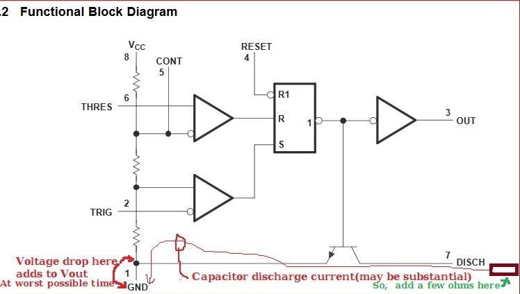

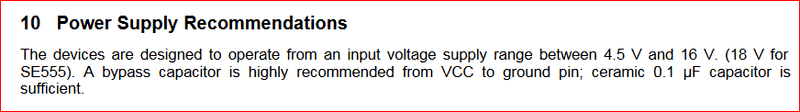

Might it be as simple as the 555 needs a bypass capacitor across power supply ?
That's a caution in its appnotes because it takes a big gulp of current at transition time. With DISCH tied direct to TRIG , the dwell at low output is very brief .(As noted by Collinsmark)
Also,
the substantial discharge current of your 100uf timing capacitor flows through the 555's "gnd" pin raising the voltage at its "Q" output terminal at the very instant you want it low.Cleaning up the power supply often solves "Mystery Problems".
Add a few microfarads across power supply , tantalum if you have one
then try a few hundred ohms in series with Discharge pin .
From 555 datasheet
and

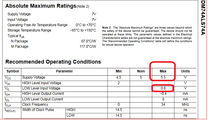

7474 datasheet :
well, i tend to use two 10k resistors to reduce the 6V source ( I have a 4x battery holder )
Well, i tend to use the resistors to reduce the 6V source ( a 4xBatteries holder, 1.5V each battery). Should i use three resistors for pin 4 and pin 10 for 7474s (As from the dataheet it's 5.5V max) or should i add a resistor to the possitive wire of the battery ?
using resistors to drop voltage isn't a good idea, as it also limits current, and may limit it to below what is required for the circuit to operate correctly
you are better to use a diode or 2, each diode, say a 1N4001, will have a 0.7V drop
that 5.5V is absolute max and I have seen 74 series chips fail at that. get down to 5V +- 0.2VDave

So when i use the bread board to test my circuit, i realize that the 7 led segment didn't have the power although i followed my design in proteus carefully. So i have another question: Is the design in Proteus reliable ??
You should be using current limiting resistors for your 7-segment.
If you care about the power up state of the flip-flops, you should use a power up reset circuit.
Per post #6, are all of your ICs being properly energized on your breadboard? Include U3 in that list.
Is your 555 oscillating at all on your breadboard?
