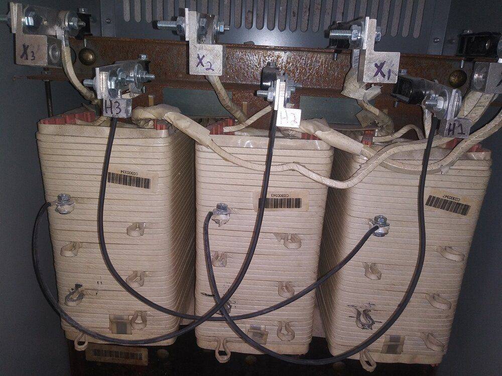

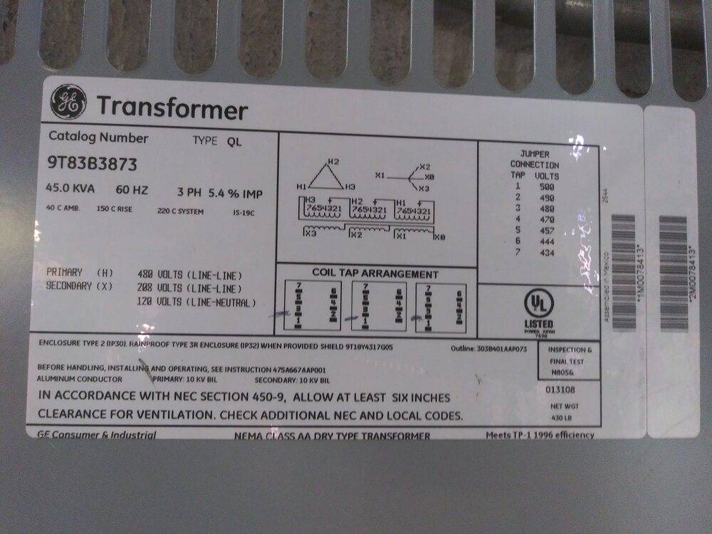

I have a 45kva GE transformer in the pics and here. Its set up for 480 to 208, i need to wire it for 250v to 208v. Could someone please point me to the correct diagrams for this general type of transformer?

Welcome to PF. :smile:
It looks like your images are no longer available. Can you use "Attach files" (lower left of window) or provide updated links?

So, I have tile kilns that run on 208v, but 248v comes into my business. To replace the elements for 208 is pretty pricy. I purchased this transformer pretty cheap, it works, but just need to figure out how to buck the voltage a little and still pull about 45 amps through. This one is set up for 480, so when I hook it up the the 3 phase at my building i get 56v to neutral, or about 112 across two of the output terminals.
Background: 15 years in hvac, degree in ee (a LONG time ago), been wiring small circuits and diagnosing general stuff for a long time
