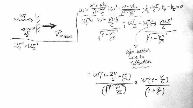

Light (plane wave) reflects from the mirror moving along X-axis with speed V. The wave is orthogonal to the mirror (φ=0°).
Write the law for frequency change.
I know Lorenz transformation for frequency.
All I do not know is how to apply the mentioned equation. I suppose if we denote ω'1 is the frequency of a falling wave in the mirror's system, ω'2 is the frequency of a reflected wave in that system, ω'1 = ω'2. Also I suppose ω'2 will be equal to the frequency of reflected wave in the stationary system. Am I wrong?
Convert the frequency \omega_1 of the wave in the lab frame to \omega_1' in the frame of the mirror. The, as you correctly state, the reflected wave has \omega_2' = \omega_1'. Convert the frequency \omega_2' of the wave in the mirror frame back to the lab frame. The conversion is done by noting that the wave phase is an absolute invariant - all observers agree on what is a crest and a trough.
Should it be like that?
