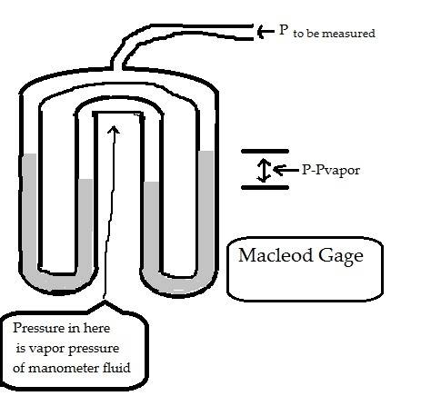

We used Macleod gage made of glass tubing. Pretty simple in principle but i had similar difficulty getting all the air out of my mercury.
Wiki has pictures of a more refined one.
https://commons.wikimedia.org/wiki/File:McLeod_gauge_01.jpgi think Cole - Parmer used to sell them, try EBAY ?
http://www.ebay.com/itm/Vintage-Virtis-Mechanical-Manometer-or-MacLeod-Gauge-/142245933349?hash=item211e84b125:g:QxMAAOSw2xRYTeXf
Never heard of that device. Looks perfect for this but I wouldn't want to mess with the mercury and it's unfortunately too expensive for my little hobby.Here is that video. Doesn't address the issues I have had with the barometer but shows it in use.
