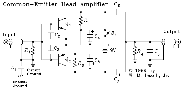

I made about 4 different low noise transistor preamps from web schematics none of them work.
Any schematic that had a transistor in it never worked when I made it like this one for eg.

Is this close to a good transistor preamp?
and do transistor preamps have lower drift than an op amp like AD8571(.005microvolt/C)?

That "low noise amplifier" doesn't look like it would do anything because it has no biassing on the bases.
The outputs should be out of phase but then they are joined together. Not sure what that is all about. Quite a strange arrangement.
Seems like it would be "low noise" OK but low everything.
I had trouble reading the schematic as well. Not drawn well at all, at least not for traditional modern schematics. Some of my older RF textbooks draw schematics like that, though -- quite the pain to try to puzzle out.
Yes, apart from being drawn strangely, I don't think it has a hope of doing anything.
I have redrawn it in case we were missing out on a little gem here, but I don't think so.
See attachment, but... DO NOT BUILD THIS... it is just nonsense.
It would be so easy to get it working, but as it stands, it would do nothing.
It was probably just someone's doodling and it was never built. Always a risk on Internet.

vk6kro said:
Yes, apart from being drawn strangely, I don't think it has a hope of doing anything. ... It was probably just someone's doodling and it was never built. Always a risk on Internet.
I wouldn't dismiss it quite so quickly. It's certainly unconventional but it might just work. A key point with this circuit is that the 9v battery supply is floating, so it's actually possible for the positive and negative ends of the battery to be simultaneously driven at the signal frequency. This is in fact how the circuit works. Both Q1 and Q2 operate as CE stages (both emitters are AC ground) and both invert the signal from base to collector, so both ends of the battery are in fact driven in phase (with each other), and these voltage swings are coupled directly to the output.
The bias in this circuit was the weirdest part to figure out. It's a bit like a currrent balance between the transistors and parallel resistors and it needs fairly well match transistors to work ideally. (Ideally so that the battery voltage floats to +4.5 volts at Q1's collector and -4.5 volts at Q2's collector). In general there will be some mismatch and the battery voltage will float asymmetrically, though it still might work well enough since it's only dealing with relatively small voltage swings.
I got the schematic from this site: http://users.ece.gatech.edu/mleach/headamp/
its the third and the first on that page is the original. Its supposed to have the noise equivalent of a 2.7R resistor.
if anyone can get that to work let me know if you used the exact same schematic they show.
Great bit of analysis UART. Maybe it could be got working.
Just playing with the drawing a bit, I came up with something a bit more conventional.
Wouldn't be too difficult to add a few components and get M718's circuit working.

I would say the original circuit posted should work. The biasing isn't all that tricky. Consider the base/emitter junction of each transistor wired in series with each other. If the transistors are a matched pair it should work. This circuit should work very well at keeping any power supply noise from getting in the output. Granted, there shouldn't be any power supply noise from a battery. Also, I would say that it stands a better chance of working well over a wide supply voltage in the event of a drained battery. vk6kro, your redrawn schematic would be a bit easier to understand if you faced the base of the NPN towards the base of the PNP.
OK about the bias arrangement. I see what you mean.
See attached picture. Something like that?
Yes exactly like that. Uart hit it pretty close with the voltage on the collectors swinging in the same direction, but I prefer my description of the bias. Maybe I've misunderstood what Uart was saying. I would also tend to think that this amplifier is a very low distortion amp. Any non-linearity in the transistors would tend to cancel out as long as each transistor distorts the same as the other since they are swinging in the opposite direction (one is going closer to cuttoff while the other is going closer to saturation). I think it is a very clever circuit.
I hope it works. That would be amazing.
This is like seeing a dead dog jump up and start barking!
The author complained that it had been used without his permission in some commercial equipment, so that sounds promising.
Not to forget M718 though. Maybe he could take some voltage readings and give component values for his actual circuit and it could be got going?
I'm guessing it didn't work because mismatched transistors.
Could be.
I guess he'll comment if he knows if they were balanced or not.
So, do you feel R4 is the actual load for both transistors?
Yes. Actually, R2 and R3 are too. All in parallel.
