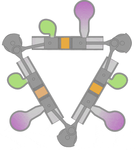

how do toroidal engines get lubricated?

This might be a place to start,
http://www.roundengine.com/

If you look in, design, and then, research, you can see a prototype and there are six tabs to click on that gives a brief explanation of the basic operation.
Lubrication would seem to be akin to a two cycle type, but that is just my guess.
The flat plate compression disc, looks to be a weak point for high compression applications, but as I stated to Danger, this is a place to start becoming aware of toroidal type design.
A design in my mind involves free piston technology, where compression takes place between the pistons rotating inside a large flywheel, inertial energy of the pistons is transferred into motion of the massive flywheel. To try and describe it would result in more infraction points I'm afraid.:frown:

I'm not sure what you need for an answer on lubrication, but there are many possible options, any of which will depend on how the design moves and what parts interact, and what speed, pressures and temperatures are involved.
Oil mixed with liquid fuel, or misting in vapor fuel, would be my guess for most designs.

how does the cylinder wall get surfaced with lubricants? and how does the lubricant get in and out of the system? it's closed,right, not like a reciprocating engine, which is open at one end.
It isn't closed any more than a reciprocating engine, Chhitiz. Those circles on the bottom surface are intake and exhaust holes that appear to be covered and uncovered by the pistons which act as valves.
What Ron is talking about regarding lubrication is something along the line of either a 2-stroke gas engine in which oil is mixed with the gas in the tank, or a pneumatic tool such as an impact wrench which has oil injected into the airflow.

then how does the oil get out? with the exhaust? is it as effective as in a reciprocating engine?
I can't speak to the efficiency; there are too many variables. The oil is indeed expelled with the exhaust if it is introduced in the possible ways that Ron mentioned. Think of how a chainsaw or a small dirtbike operates. The exhaust is blue because the oil is burned with the fuel, after having done its lubrication duty.

I was always thought these were clever - and they worked.
They ran big locomotives for 40years.
