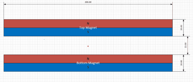

Hi all,
I have two identical magnet which measures 0.6T when I put my gauss meter on the top surface. I configured the magnets as below:
I would like to know what should I expect if I measure the strength(Tesla)at the red round dot position? Would it be 1.2 tesla?
Please advise.
Thank you
Regards,
Vincent
Depends on details of the surface measurement, but I would expect a value close to 0.6 T.
I agree, provided the gap is small, I would expect 0.6T.
Vincent, an easy visualization why is, imagine the magnetic field lines coming out of the North pole of the bottom magnet. Now, because the top magnet is of equal strength, equally as many field lines need to enter into the South pole of the top magnet. The easiest way? All field lines from the bottom magnet go straight into the top magnet. Meaning, the lines will all be parallel to each other.
That means then the magnetic field anywhere in that gap is the same, and since we know it's 0.6T at the surface of the magnets, we know its 0.6T anywhere in the gap.
