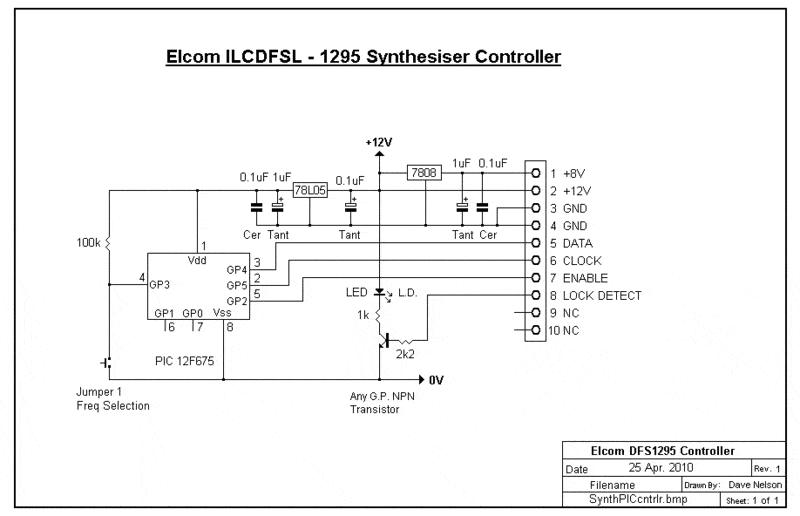

Hey Carl
I use MSpaintbrush for all my schematics and have done so for some 15 years ... it produces VERY sharp images both for www pages, printing and other general use
I initially draw it in xxx.bmp monochrome and usually save a copy that way
and for use on www site I convert it to xxx.gif to produce a file only a few kb in size but still top quality ( as good as the .bmp
see here ... http://www.sydneystormcity.com/harris23.htm for a complex layout example
or even this less complex example ...
Dave
