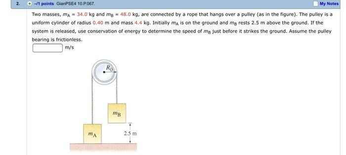

Cdh0127
http://imgur.com/koz4PpI
I was able to calculate the net torque on the pulley as 55.88 and the Inertia as .352. Those could be wrong, but that's as far as I could get. I really have no idea. Any kind of help/explanation would be wonderful!

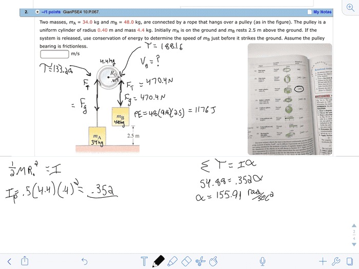

I just added a screenshot of my work. I hope you can make sense of it xD
You'd be better off laying out your work in text in a post, explaining the steps. That way helpers can quote the lines and point out issues. Otherwise you're expecting them to forensically untangle where you started and what you did from the scatter of notes on the image. You're really limiting the number of helpers who'll be willing to make the effort that way.
Just to add my 2 cents from a quick perusal of your diagram, it doesn't appear that you went anywhere with the conservation of energy approach suggested in the problem statement. You went after torques and forces instead.
Rethink your approach. Where does the energy come from to make the system move? How much energy is made available from the initial position to the final position? Where does it go?
