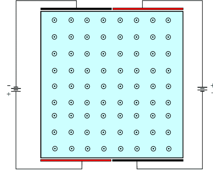

Hi,
I am looking for some information regarding maximum current density in conducting mediums, such as a conducting fluid. Say that we have a setup like the figure that I have attached. We are looking down on a conducting medium with a uniform magnetic field coming out of the page and the electrodes attached as shown. I know that theoretically, the E field (and thus current) generated by the external load will be irrotational. I am wondering what will happen, in reality, at the singular locations between the electrodes where the magnitude of the E field will tend to infinity. Of course, the currents here will exceed the maximum current density that a physical conductor is capable of accommodating. What will the result look like, in general? Will this cause the field to become rotational? Divergent? I haven't been able to find much information about such a process, so any thoughts or recommendations for related articles or studies would be extremely helpful.
Thanks a lot.
Why would the E-field be high there? Can you add to your sketch to show these regions? The way you've drawn the circuit, the 2 sources of E-fields are not related to each other (they are floating)...
Sorry, I should change the figure. The electrodes are supposed to be touching the conducting medium. So there are infinitely large current right at the joining point of the electrodes (essentially a dipole here).
So the horizontal centerline of the cell will tend to be at zero volts, and the voltage sources bias the ends to +/- V/2, I guess. You are asking about where the opposite polarity plates contact the conducting medium, but are only separated by an arbitrarily small distance. You can model this with a network of resistors, where the resistance does lower as the current density goes up. That should probably model the real physical situation, at least for normal conductors.

@Toodles : Could you please give us a much better explanation of what this problem is all about ?
(1) For a highly conductive fluid all I see is two shorted out batteries where current in the external loops will be limited by the internal resistance of the batteries .
(2) For a weakly conducting fluid all I see conceptually is four resistances in a square . One resistance each linking top to bottom pair of electrodes and one resistance each linking side to side pairs of electrodes . The side to side resistances are relatively low value and the top to bottom resistances relatively high value . Current flowing in the external loops is determined by the internal resistances of the batteries and the values of the resistances between the electrodes .
(3) If accurate numerical results are needed for fluid with any level of conductivity the four resistance model could easily be expanded into a mesh of resistances as advised by @berkeman or a quasi continuum model could be set up using finite difference or finite element methods on computer .
(4) The finite element model could be set up to handle non linear resistance and possibly external influences like the magnetic field which you mentioned but did not explain the influence or purpose of .

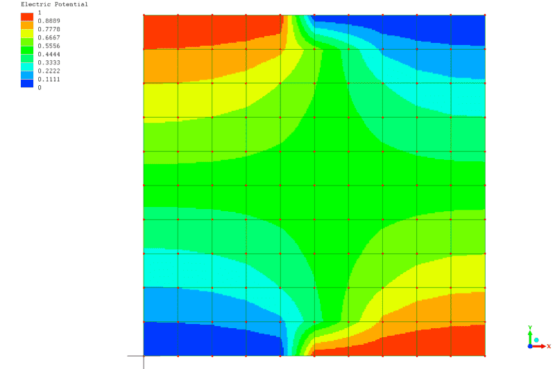

Only a five minute try out with FEA . I obviously need to have a denser mesh around the split line between electrodes to get better accuracy in that area .
Was this simulation done with a linear resistivity?
