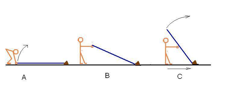

Imagine raising a long ladder by "walking" it from a horizontal position to a vertical one as illustrated n the Figure. The first few steps are not difficult, but the job becomes increasingly difficult. However, beyond a certain point the job becomes easier again and when the ladder is vertical all you have to do is keep the ladder balanced.
Consider a uniform ladder of mass m and length l, lying on the ground with its base anchored against a brick. The ladder is slowly raised to a vertical position by applying a force at a constant height h above the ground. Consider the case where the ladder is raised using minimal effort.
a)Find the angle the ladder makes with the ground when lifting force is a maximum.
b)Find the magnitude Fmax of this maximum force.
torque = rF sin(theta)
I used L for r and Fmax was when it had the max force. So i tried using mg for the force of the ladder, but I'm unsure how to apply height in finding the Force, since using mg the force is the same no matter what. Some tips to help me in the right direction would be appreciated.

Is this the set-up?
At stage A the man lifts the end of the ladder up to the height of his shoulder (B). Then he keeps his arms horizontal and pushes the ladder while walking forward (C). ladder rotates around the fixed point on the ground. Find the force that keeps the ladder in equilibrium at different angles with the horizontal.

The direction of the force the man applies to the ladder is not given. I suggest it should be taken to be the direction which minimises the force.
The verbiage "keeps his arms horizontal" suggests that the intent is to use a horizontal force instead.
Edit: That wording is present in ehild's rephrasing but was not present in the original. In addition, the original mentions that the task "becomes increasingly difficult". This rules out the horizontal interpretation. I believe that Haruspex has the correct interpretation.
Horizontal arm does not necessarily mean to apply force horizontally. It can be directed normal to the ladder. You grab the ladder with your hands, and can exert a normal force. With horizontal arms, I meant the application point of the force at constant height, so you have to shift your hands along the length of the ladder.
