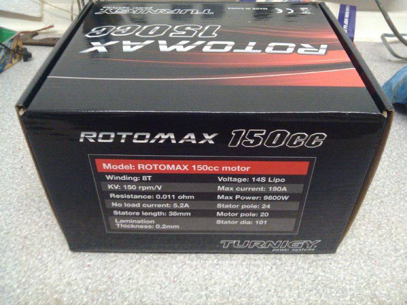

I plan to use below DC motor to use as load. Its resistance is 0.011 ohm. It says winding it 8T, which I'm not sure what it is.
Why do you think that since you are using permanent magnets that the dangers or circulating currents don't apply to you?

I think if I use Diodes, current won't go in reverse direction or in other coil. I'll be rectifying each coil current and then supply it to the DC motor.
Circulating currents can exist when there are no diodes hooked up or if you are not taking any power from the alternator.
