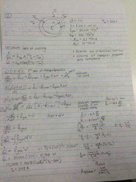

Radioactive wastes are stored in a spherical stainless tank of inner diameter 1 m and 1 cm wall
thickness. Heat is generated uniformly in the wastes at a rate of 30,000 W/m3. The outer
surface of the tank is cooled by air at 300 K with a heat transfer coefficient of 100 W/m2 K.
Determine the maximum temperature in the tank at steady state. Take the thermal
conductivities of the wastes and steel tank as 2.1 W/m K and 15 W/m K, respectively.

Anyways, I calculate the outside temperature of the shell to be 348 K, and I calculated the heat flow to be 15,708 W. Now, I need the inner temperature, so I suppose I will start with Fourier's law
[tex]\dot Q_{steel} = -k_{s}A_{s} \frac {dT}{dr}[/tex]
[tex]15,708 = -15 \pi (1.02^{2} - 1^2) \frac {dT}{dr}[/tex]
[tex]-8250.8 \int_{0.5}^{0.51} dr = \int_{T_{i}}^{348} dT[/tex]
And I calculate the inner temperature of the steel wall, ##T_{i} = 430.5 K##.

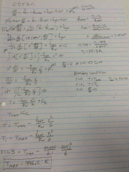

Sorry, but the shell and the core are done incorrectly.
For the shell, the equation should read:
[tex]15708=-4\pi r^2k\frac{dT}{dr}[/tex]
You need to integrate this equation with respect to r.
For the core, not all the heat flow passes through each surface of constant r, only the heat flow coming from inside the surface of constant r. So,
[tex]15708\left(\frac{r}{R}\right)^3=-4\pi r^2k_w\frac{dT}{dr}[/tex]
Where R is the outer radius of the core (inner radius of the shell).
You can get this same result from one of your earlier equations:
[tex]r^2 \frac {dT}{dr} = - \frac {\dot e_{gen}}{k_{w}} \frac {r^3}{3} + C_{1}[/tex]
This equation must hold at r = 0, so setting r = 0 gives C1=0
Therefore,
[tex]\frac {dT}{dr} = - \frac {\dot e_{gen}}{k_{w}} \frac {r}{3}[/tex]

Okay, I did this after some more thought, and a little help from a TA to get started, but here is what I did. I just found out recently that I had to set the first constant of integration to 0.
Nice job.
Chet
