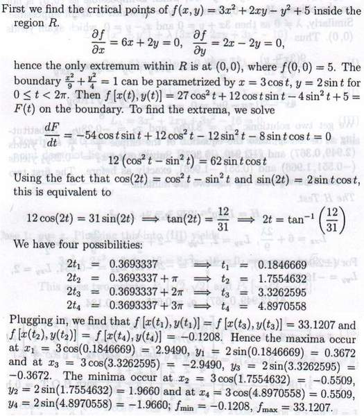

The electrostatic potential at each point in the region 4x^2 + 9y^2 <= 36 is given by f(x,y) = 3x^2 + 2xy - y^2 + 5. Find the maximum potentials in the region.
(Without using Lagrange Multipliers).
The solution also said how to do it with Lagrange Multipliers but I think I understand that but I want to understand how to do it using this method. Also, if someone could tell me what this method is called it would be appreciated.
Partial derivatives and parametrization.
I looked through the full solution and I can see how to do it algebraically but I have some questions/confusions I need to settle.:
1) Why is f(0,0) = 5 not a valid final answer?
2) Why does parameterizing things to use a single variable t help?
3) What's the reasoning behind the 0 <= t < 2π constraint on t?
Any input would be GREATLY appreciated!
Thanks in advance!

Just like a single variable question, you must check the "interior" extremum and the points on the boundary.
With this mind, and without checking the working:
1) as there is a larger value (fmax) obtained on the boundary
2) the curve parameterised by t represents the boundary of the region of interest
3) the boundary is a circle so (0,2pi) is a natural choice, though you could choice any interval to parametrise over

Thanks for the answers but I have more questions.
1) I can see why the interval would be [0,2π] since it's a circle. Just to be clear, it can be any interval as long as it's an interval covering a full period, right?
2) Why do the solutions say [0,2π) instead of [0,2π]?
3) Why do ∂f/∂x and ∂f/∂y only yield x = 0? Is it because, linearly, a circle only has rate of change 0 at the top and bottom (thinking of a 2D unit circle here for simplicity) which has a "shadow" down to x = 0?
4) What is the boundary in this problem algebraically (geometrically it is a sphere/circle as you guys stated)?
5) What is the "interior" in this problem algebraically?
Sorry for the stupid questions but please answer them as it will improve my grasp of the concepts.
1) yes as long as the parametrisation cpovers the whole boundary, you could use [0,1) if you wanted, you would just need to re-think the parameterisation
2) [0,2pi] would repeat one point on the boundary twice (x(0),y(0)) = (x(2pi),y(2pi))
3) don't understand the question
4) its given as [itex]\frac{x^2}{4} + \frac{y^2}{9}=1[/itex] which is an ellipse
5) the interior is all points in R^2 within the ellipse [itex]\frac{x^2}{4} + \frac{y^2}{9}=1[/itex]

Because if the extremum occurs on the boundary the partial derivatives don't have be zero there.
1) Why and how does the equation with the t variables take into consideration the boundaries?
2) Why are there four values for t and not three? I ask this because 2π radians covers the entire circle so why is there an answer with +3π (the t_4 part)?
On the boundary there are two local maxima and two local minima, for a total of 4 extrema.

What is preventing you from drawing a graph of the function f(t) for 0<= t <= 2Pi?
The boundary is given by the constraint [itex]4x^2 + 9y^2 \eq 36[/itex]
the following paramsterisation represents the curve (an ellipse) defined by the constraint [itex]4x^2 + 9y^2 = 36[/itex]
[tex]\begin{pmatrix} x(t) \\ y(t) \end{pmatrix} = \begin{pmatrix} 3cos(t) \\ 2sin(t) \end{pmatrix}[/tex]
to see this, substitute in as follows
[tex]4x(t)^2 + 9y(t)^2 = 36[/tex]
[tex]4(3cos(t))^2 + 9(2sin(t))^2 = 36[/tex]
[tex]4.9cos^2(t)) + 9.4sin^2(t) = 36[/tex]
[tex]36(cos^2(t)) + sin^2(t)) = 36[/tex]
if you read the answer you will see
[tex]2t_4 \approx 0.369+3 \pi[/tex]
which gives
[tex]t_4 \approx 4.897 \leq 2 \pi[/tex]

The function f(x,y) = 3x^2 + 2xy - y^2 + 5 has no max or min inside the region; the point (0,0) is NOT a max and NOT a min; it is a saddle point! You don't believe it? Look at f(t,0) for small t ≠ 0. You have f(t,0) = 2t^2 + 5 > f(0,0), so t = 0 is a min. That is, (0,0) is a min along the x-axis. Now look at f(0,t) = 5 - t^2. We have f(t,0) < f(0,0), so (0,0) is a max; that is, (0,0) is a max along the y-axis. So, within any neighbourhood of (0,0) there are points (x,y) giving f(x,y) > f(0,0) and other points (x,y) giving f(x,y) < f(0,0).
You should have tested this yourself; an application of the second order tests would have shown it right away.
RGV

I don't understand your confusion. The function f(x,y) does not have a max or a min inside the region, so we need to look on the boundary; that is, we must deal with the problem max/min f(x,y), subject to g(x,y) = 0. The derivatives of f need not (and usually will not) be zero at the optimal solution. That is why we use Lagrangians instead.
It so happens that in this particular problem we can parametrize the constraint curve in terms of an angle t in [0, 2*pi) and can therefore express the CONSTRAINED value of f as a function of t. That reduces the problem to a unidimensional optimization problem. That means that in this problem we can forget about using a Lagrangian and instead, use f itself---but f on the boundary, not anywhere else. You could arrive at exactly the same solutions by using the Lagrange multiplier method, but it takes more work.
Please tell me clearly: what part of the previous explanation do you not understand? I really cannot see what your problem is.

If you want to maximize f(x,y) [or minimize it] you do _not_ want to set f(x,y) = 0; that might not even be possible, as the example f(x,y) = (x + 2y - 3)^2 + (4x - y)^2 shows (this f is > 0 for all real numbers x and y).
The problem you started with is max/min f(x,y) = 3x^2 + 2xy - y^2 + 5, subject to 4x^2 + 9y^2 <= 36. This has a max at (x,y) = +-(A1/C1,B1/C1), where A1 = 18*sqrt(2), B1 = sqrt(2)*[sqrt(1105) - 31] and C1 = sqrt[1105 - 31*sqrt(1105)] (so (x,y) = +-(2.94899,0.36724) and f = 33.1208). It has a min at (x,y) = +-(A2/C2,B2/C2), where A2 = -18*sqrt(2), B2 = sqrt(2)*[31 + sqrt(1105)] and C2 = sqrt[1105 + 31*sqrt(1105)] (so (x,y) = +-(-0.55086,1.96599) and f = -0.12077).
You seem to be confused about the nature of the point (0,0), where the derivatives of f vanish. As I already said _several times_, the point (0,0) is NOT a max or a min; it is a saddle point. The max and min of f lie on the boundary of the constraint set, and the derivatives of f do not vanish there.

For the problem [itex]\max/\min f(x,y) = 3x^2 + 2xy – y^2 + 5,[/itex] subject to [itex]g(x,y) = 4x^2 + 9y^2 – 36 \leq 0,[/itex] the optimum occurs on the boundary g = 0. Letting the Lagrangian be [itex]L = f - u g[/itex] (where u is the Lagrange multiplier), the optimality conditions are
[tex]L_x \equiv \partial{L}/\partial{x} = (6-8u)x +2y = 0 \text{ and }<br /> L_y \equiv \partial{L}/\partial{y} = 2x -(2+18u)y = 0.[/tex] This system of equations is linear in x and y and homogeneous. In order to have a nonzero solution we need to have the determinant of the coefficient matrix = 0, that is, we need
[tex]\left| \begin{array}{cc} 6-8u & 2 \\ 2 & -2-18u \end{array}\right| = 0,[/tex]
or [tex]144u^2 - 92u - 16 = 0 \longrightarrow u = u_1 = \frac{23}{72} + \frac{\sqrt{1105}}{72} \text{ or } u = u_2 = \frac{23}{72} -\frac{\sqrt{1105}}{72}.[/tex]
Using [itex]u = u_1 \text{ in } L_x = 0[/itex] gives
[tex]\left(\frac{31}{9} - \frac{\sqrt{1105}}{9}\right) x + 2y = 0,[/tex] so we can get
[tex]x = \frac{18 y}{31 - \sqrt{1105}},[/tex] and substituting this into the equation g = 0 we get two roots for y, in the form [itex]y = \pm \, y_1.[/itex] Substituting these back into the formula for x gives two values of x. These two points are the constrained maxima.
Similarly, if we use [itex]u = u_2[/itex] and repeat the above steps we obtain two mirror-image points that are the minima.

s3a said:
I don't know if you were trying to imply that that last equation is ugly/difficult but I find that it is quite do-able actually. Having said that, my troubles have been solved and my curiosity has been satisfied. :)
Thank you very much!
Of course it is do-able; I never claimed it wasn't. I just asked you how you like it; personally, I don't much like it myself, but if there was no other way to proceed, I would deal with the equation anyway.
But, the point I was making really rears its ugly head if you have, say 4 or 5 variables and two or three nonlinear constraints. Then the equations become truly unmanageable, except using numerical methods (which, BTW, is done all the time in applications, using sophisticated modern optimization packages that have been developed by teams of researchers over decades of trying).
RGV
Could you answer me for my tan(2t) = -12/31 problem? (I'm just repeating in case you didn't see it because of the timing of that post.)
I noticed that multiplying the angles in the sine functions all by -1 in the code yields the correct answer along with double t1 = Math.atan(-12.0/31.0)/2.0;.
So basically, taking the negative arctan and the negative sines yield the same extrema. Why exactly is this the case? I'd appreciate an explanation that can make it stick for me in a problem-independent way.
Edit: Is there a reason why it would be wrong to use x = 3sin(t) and y = 2cos(t) instead of x = 3cos(t) and y = 2sin(t)?
