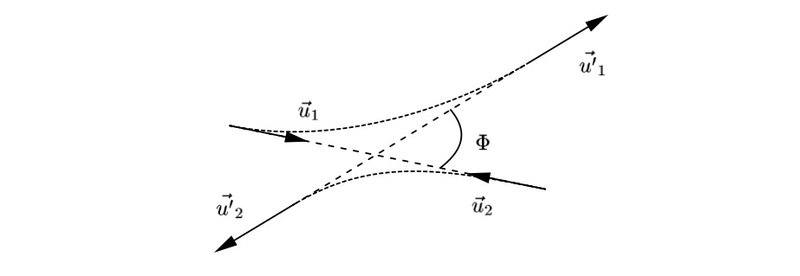

A particle of mass ##M## and speed ##v_1## bumps a particle of mass ##m##, ##(M >m)##, at rest. Find the maximum angle of deflection of ##M## after the bump.
I would like to solve this problem in the reference frame of the center of mass, because it seems that the counts are very little :D
By definition, if I call ##u_1,u_2## the velocities of the particles in the CdM reference frame, I have ##p_{CdM}=Mu_1 -mu_2=0##. Then I call ##u_1 ',u_2 '## the velocities after the bump (the quantity of motion of Cdm is 0 also after the bump). In the image there is a sketch of the situation, with ##\phi## the scattering angle. But now I'm struggling in relating the velocities ##u_1,u_2,u_1 ',u_2 '## with the end velocities of the particles ##v_1 ', v_2'## in the frame of the laboratory. My question is: how to sketch this four vectors?
In the CoM frame the masses can go in any direction. The problem asks for the frame where the larger mass is initially at rest.
