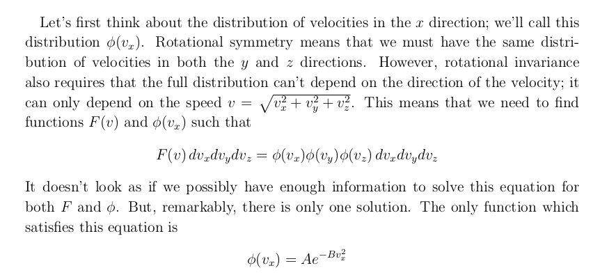

The attached image shows the text I am following. I get that the 3-D pdf F can only depend on the speed v. I also understand that if f_x , f_y, f_z are the pdfs of the individual components of velocity, then rotational invariance requires them to all be the same function f_x = f_y = f_z = ϕ. What seems to be missing is that F must be separable, that is F must satisfy
F = f_x f_y f_z
Why must F be separable?
  • Printed text from a physics derivation of the Maxwell-Boltzmann velocity distribution: rotational invariance means the full distribution depends only on speed, with the equation F(v) dv_x dv_y dv_z = phi(v_x) phi(v_y) phi(v_z) dv_x dv_y dv_z, leading to phi(v_x) = A exp(-B v_x^2).
That's the assumption that the three velocity components are stochastically independent. Thus you have the ansatz
$$F(v)=f(v_x) f(v_y) f(v_z).$$
To get the functions ##F## and ##f## we take the logarithmic derivative with respect to ##v_x##, which leads to
$$\frac{1}{F(v)} \partial_{v_x} F(v)=\frac{1}{F(v)} \frac{v_x}{v} F'(v)=\frac{f'(v_x)}{f(v_x)}$$
or
$$\frac{F'(v)}{v F(v)}=\frac{f'(v_x)}{v_x f(v_x)}.$$
Now we define
$$\Phi(v)=\frac{F'(v)}{v F(v)}, \quad \phi(v_x)=\frac{f'(v_x)}{v_x f(v_x)}.$$
Then we have
$$\Phi(v)=\phi(v_x).$$
Then we take the derivative of this equation with, say, ##v_y##. The right-hand side doesn't depend on ##v_y## and thus
$$\frac{v_y}{v} \Phi'(v)=0 \; \Rightarrow \; \Phi'(v)=0 \; \Rightarrow \; \Phi(v)=C=\text{const}.$$
Thus we have
$$\Phi(v)=\frac{F'(v)}{v F(v)}=C \; \Rightarrow \; \frac{F'(v)}{F(v)}=C v \; \Rightarrow \; \ln \left (\frac{F(v)}{F(0)} \right) = \frac{C}{2} v^2 \; \Rightarrow \; F(v)=F(0) \exp \left (\frac{C}{2} v^2 \right).$$
For this to be properly normalizable distribution function, we must have ##C<0##, and thus the distribution is Gaussian. Now writing ##C=-2 \gamma## with ##\gamma>0##
$$F(v)=F(0) \exp (-\gamma \vec{v}^2)$$
and
$$f(v_x)=[F(0)]^{1/3} \exp(-\gamma v_x^2).$$
Thank you for that. I follow all the steps but the first one. Why do we assume that the three velocity components are stochastically independent?
That's an assumption. You can not derive it otherwise it would not be an assumption. It is quite intuitive though.
