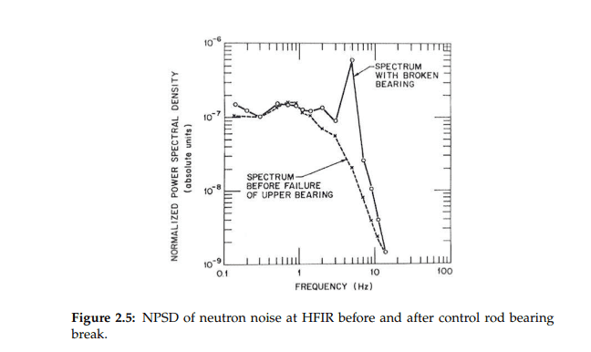

Most everything in nature is moving if you look at it close enough. In the plant it was not practical to measure closer than 0.1%, a part per thousand, because every signal has "noise" imposed on it. 0.1% takes only a 10 or 11 bit ADC. We installed a 14 bit (15 including sign) ADC for our computer because its drift and nonlinearity were so small relative to our 10 bit need that it could go for years between calibrations. That saved a LOT of man-hours.
There's a whole niche industry focused on analyzing that 'noise' riding atop process signals.
https://www.kth.se/polopoly_fs/1.469664!/In-Core%20Neutron%20Noise%20Analysis%20for%20Diagnosis%20of%20Fuel%20Assembly%20Vibrations.pdf
Log-log plot of normalized power spectral density against frequency in Hz, showing neutron noise at HFIR before and after a control rod bearing break; the broken-bearing spectrum has a sharp peak near 5 Hz, while the pre-failure spectrum decreases smoothly.
typically one uses an analog high pass filter to block the steady state signal and amplify just the noise, then a fast ADC connected to a FFT analyzer.
In my day that took 200 pounds of computer equipment, nowadays they do it with a DSP processor that fits in your shirt pocket.
old jim
  • Log-log plot of normalized power spectral density against frequency in Hz, showing neutron noise at HFIR before and after a control rod bearing break; the broken-bearing spectrum has a sharp peak near 5 Hz, while the pre-failure spectrum decreases smoothly.
