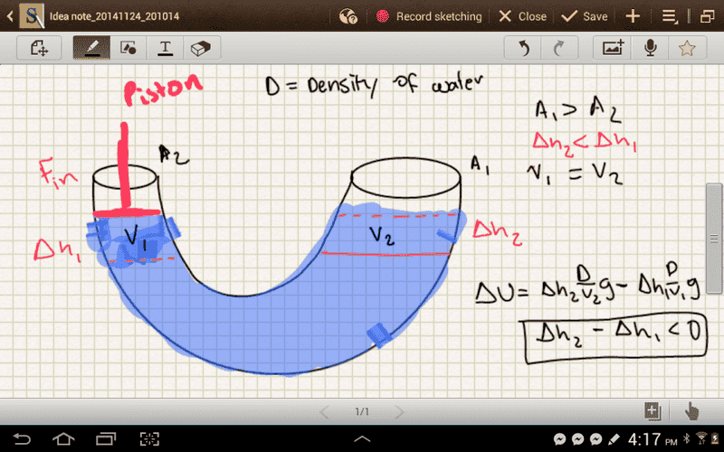

I want to understand what happens to the energy inputted into a simple machine if there is no resistance or load. For example, let's say you have a U-shaped tube of water with greater surface area on the left side. If a piston applies pressure to the left side and there is no piston on the right side, what does the water apply pressure to on the left side? Where does the energy go?

If you have a mechanical device with no load and you input energy, then you will raise the internal energy of the device, usually to internal KE and PE, vibrations, and heat. The vibrations and heat can then dissipate the energy to the environment, sometimes after breaking the device.
The minimum Potential Energy is (of course) when the two water columns are leverl. To change that situation requires work to be done. Work out (in proper detail) what happens to the centre of mass of the whole mass of the water. Either do it with algebra (preferable) or for a specific example (which isn't a proof - its just an indication).
PS - did you actually work it out or are you just repeating what I wrote?
I worked it out. I found that M, and g, are same on both sides and that -h, height water displaced downwards, is greater than +h, height water displaced upwards. Isn't that sufficient to say potential energy is decreased?
DaleSpam said:
If you have a mechanical device with no load and you input energy, then you will raise the internal energy of the device, usually to internal KE, vibrations, and heat. The vibrations and heat can then dissipate the energy to the environment, sometimes after breaking the device.
So essentially the water increases in temperature? What would happen in the lever case if no hole is created?
Please show your work in detail. You made a mistake, the PE increases.

Heres my calculation for the manometer

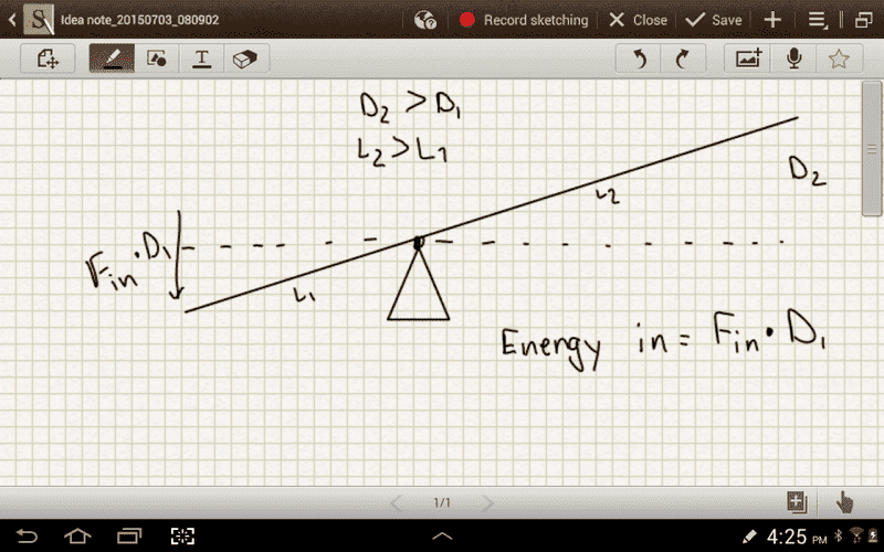

Heres a diagram for the lever.
UMath1 said:
Heres a diagram for the lever.View attachment 91468
What is the mass of the lever? This will determine how much force can be/has to be applied to move it.
Lets say it has a nonzero mass, M.
Great! So, can you use geometry to calculate the force required to hold the lever stationary and level or move it?
Hints:
1. The force to hold it stationary or move it is the same if you move it slowly.
2. The force doesn't change if we keep the rotation angle small.
By the way, just to make sure we're clear: you do recognize now that the starting premise of the thread, "no resistance" is false, right? Every scenario you've constructed includes resistance.
You have shown that net work is needed to disturb the levels from the same height. That's good enough because the system will tend to return. Aamof, the net GPE will have Increased - so the system will 'fall' to a lower energy state as the levels go back to where they were.

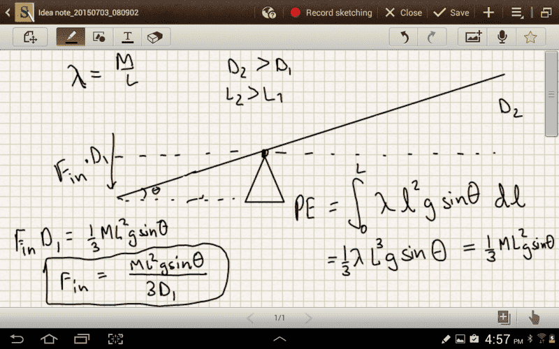

In a machine with no load then any energy / work put in must end up as heat, distortion etc or Kinetic energy.
I am not sure if I did this right, but if I assume that all of the energy becomes potential energy..then this would be the force. But I don't know whether that is correct, because if there had been a load, the displacement would still be the same but the energy of the lever would not change.
Can you explain how it will have increased based on the manometer diagram?
Work has been done to alter the levels from the equilibrium heights. If not, the system would not be stable and the water would go shooting out of the U, one way or another. That's the philosophy behind it. The reason that you get a negative will be because of the sign you have chosen for the directions used. The calculation should show that the work put in is greater than zero (making the PE of the system less negative).
