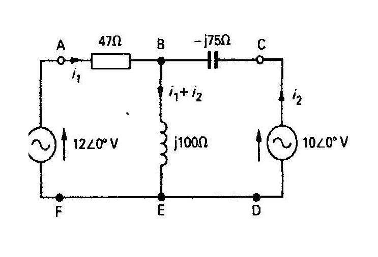

Use mesh-current analysis to determine currents I1, I2 and I1 + I2 for the network shown.My calculation so far:
Mesh A: v1+v2=12∠00
Mesh B: -v2+v3=-10∠00
v1=i1RA=(47Ω)iA
v2=iAR2=R2(iA-iB)=(j100Ω)(iA-iB)
v3=iBR3=(-75j)iB
Mesh A: (47Ω)iA+(j100Ω)(iA-iB)=12∠00
Mesh B: -(j100Ω)(iA-iB)+(-75j)iB=-10∠00
I'm stuck

Have you tried distributing j100 Ohm and -j100 Ohm and then combining like terms?
